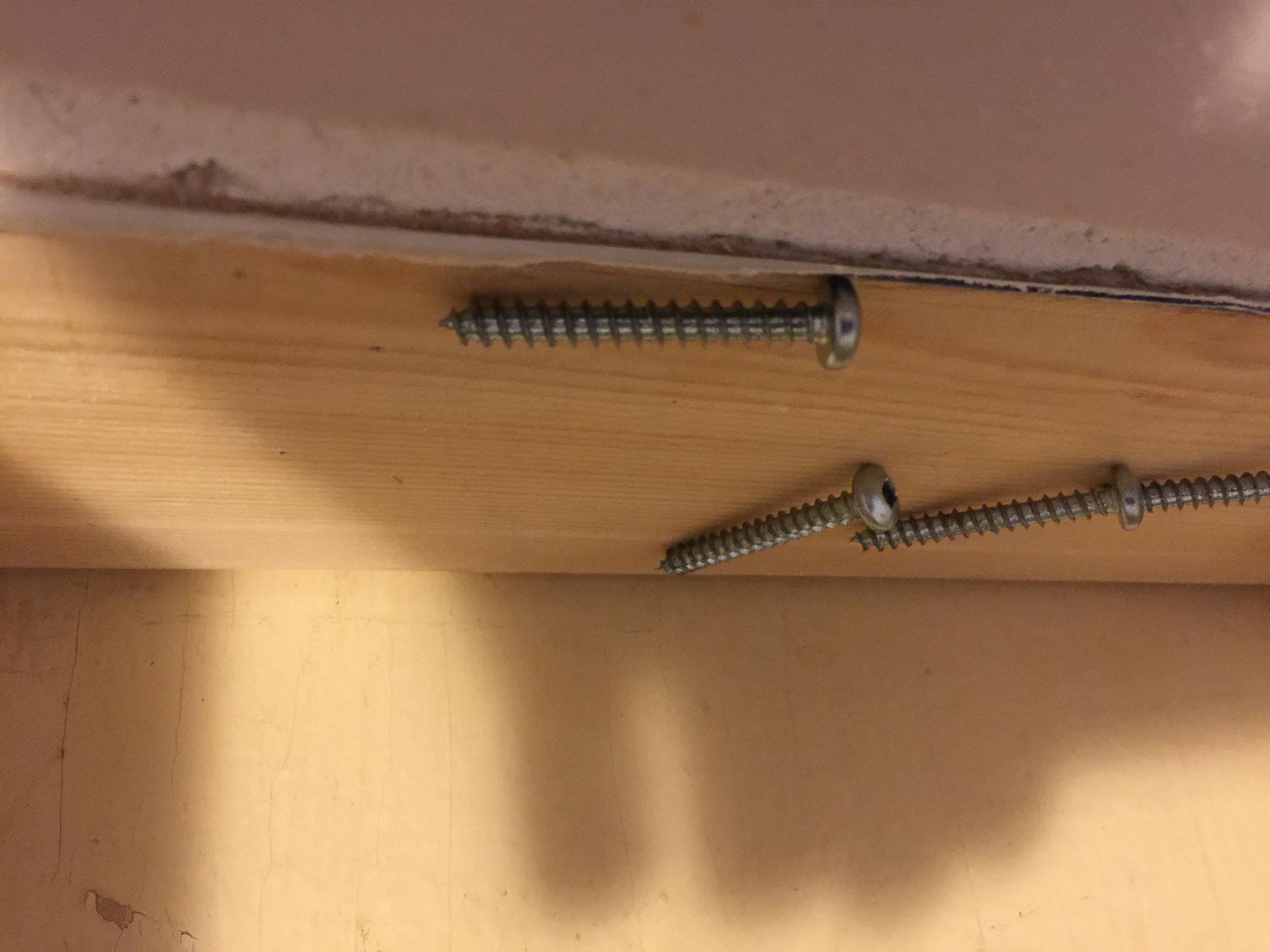

Here’re pictures of my inspection of an electrical panel:
From the pictures you can see the wood screws being used for the dead panel, which is absolutely wrong and prohibited.
For cables enter into the panel box, no bushing being used for cable/wire protection. The bushing should be ground bushing.
The AFCI breaker was double taped
Those conductors look too small to require a bushing. Why do you think needs to be ground bushing vs a standard bushing?
An afci breaker has a tail for the neutral along with the circuit neutral. That is probably not a double tap.
I see the that conduit is without a bushing which would be required when using RMC or another raceway which contains conductors #4 and larger. It is possible that the bonding bushing is on the other end of the raceway and therefore not required in the panel.
I do see two sets of conductors on the AFCI breaker which is likely a “double tap” as you’ve stated.
Also the bare neutral and GEC are terminated on the same lug which isn’t listed for two conductors.
