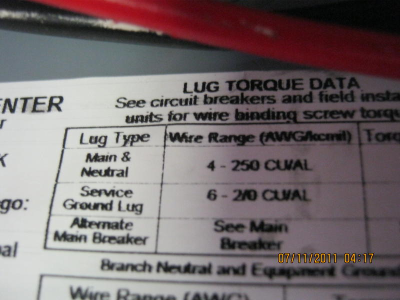

Correct size wire(s) for 200 amp breaker? Anyone have wire sizing chart? Thanks in advance.
3/0 in Canada
NEC, 200 amps=#2/0 Copper or #4/0 Aluminum, #2 cu=125 amps, all with some restrictions. Table 310.15(B)(6)-2008 NEC.
So to answer my first question?? Is this 2/0 in the picture(s)?
Looks like #2 Copper, from photo {2 AWG}.
Again I ask, Is this the correct wire size for 200 amp breaker and/or what is the difference between #2 and 2/0?? Thanks.
Did you read post #3? The answer is no for 200 amps.
2/0 (two naught) pronounced “two not” is a larger wire and will carry the 200 amps by your codes. #2 is good for up to 125 A depending its installation, configuration e.g. in open air, in a raceway, in a 3 wire cable, etc.
In the US wire sizes bigger than #1 go by zero’s or aught (pronounced ought) a derivative of naught.

Get yourself a copy of Code Check, which has the attached table and a bunch of other usefull basic code info for HI’s. With that table keep in mind that you can get more out of wires in conduit, and it doesn’t necessarily apply to AC condenser circuits (check the nameplate for that).
