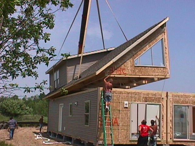

Modular Home Inspection is done the same as anyother home. They are built with the same type lumber and are built to state and local codes. (IRC) if they were built in the last few years. Some States requier a lable on the out side of the building saying that this is a factory built home and it meets the IRC or IBC and the year. Some two story Modulars the steel frame or tralier may remain under the floor of the second story. I only know this to happen in one project. On the east cost some modular homes will be built with wood and steel. If you anyone needs more help contact me. We had a large project completed of 400 units and planing on building 290 more this coming year.

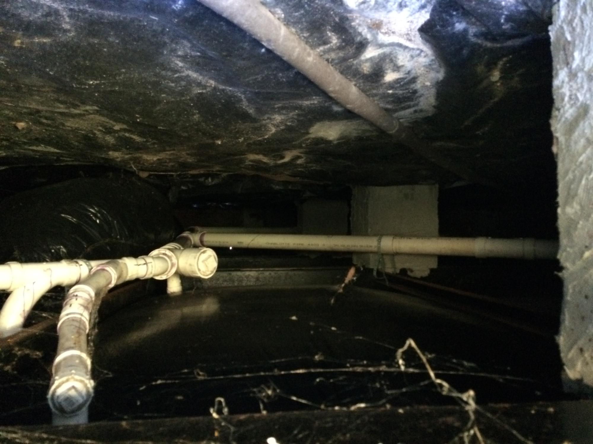

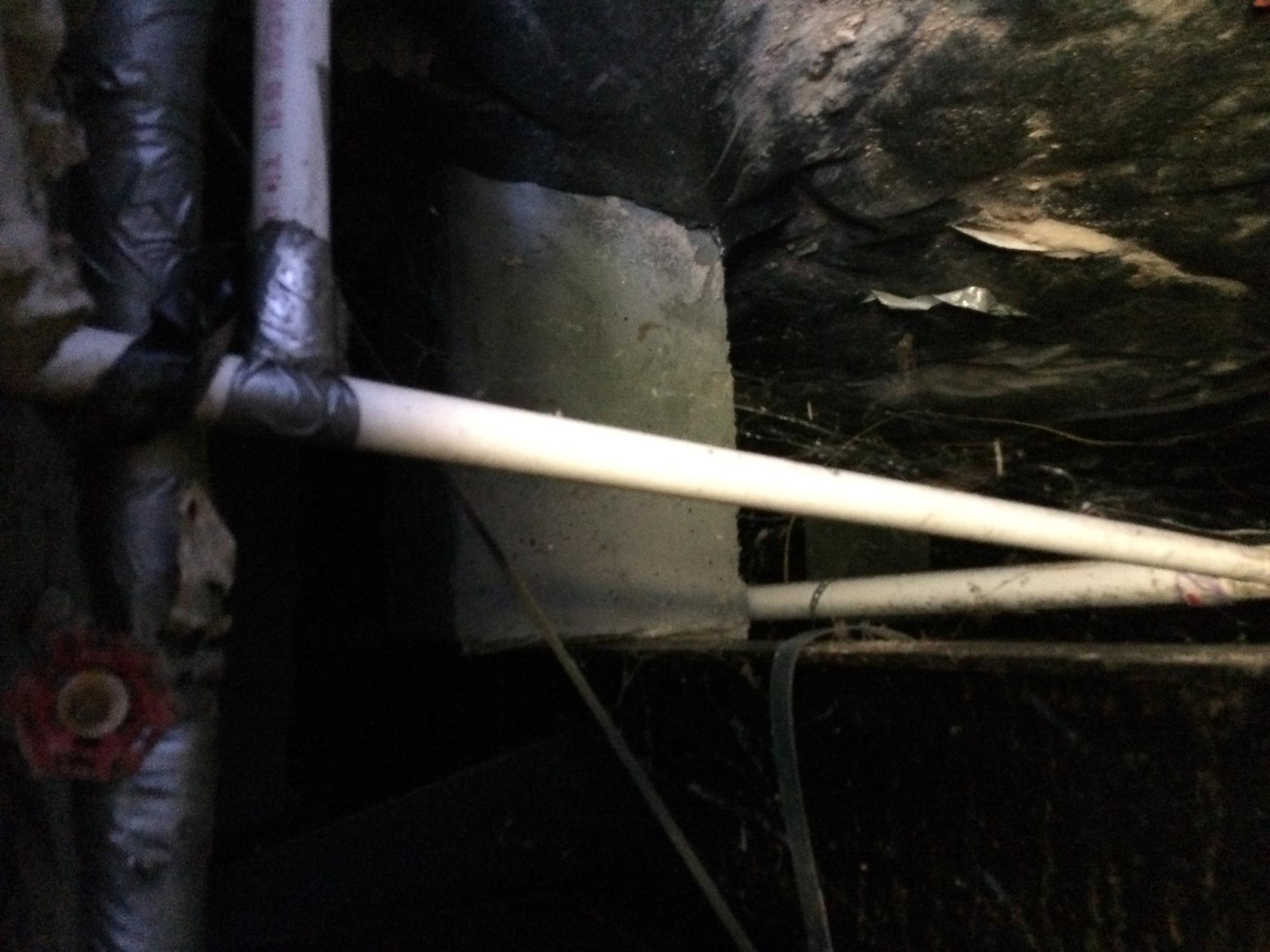

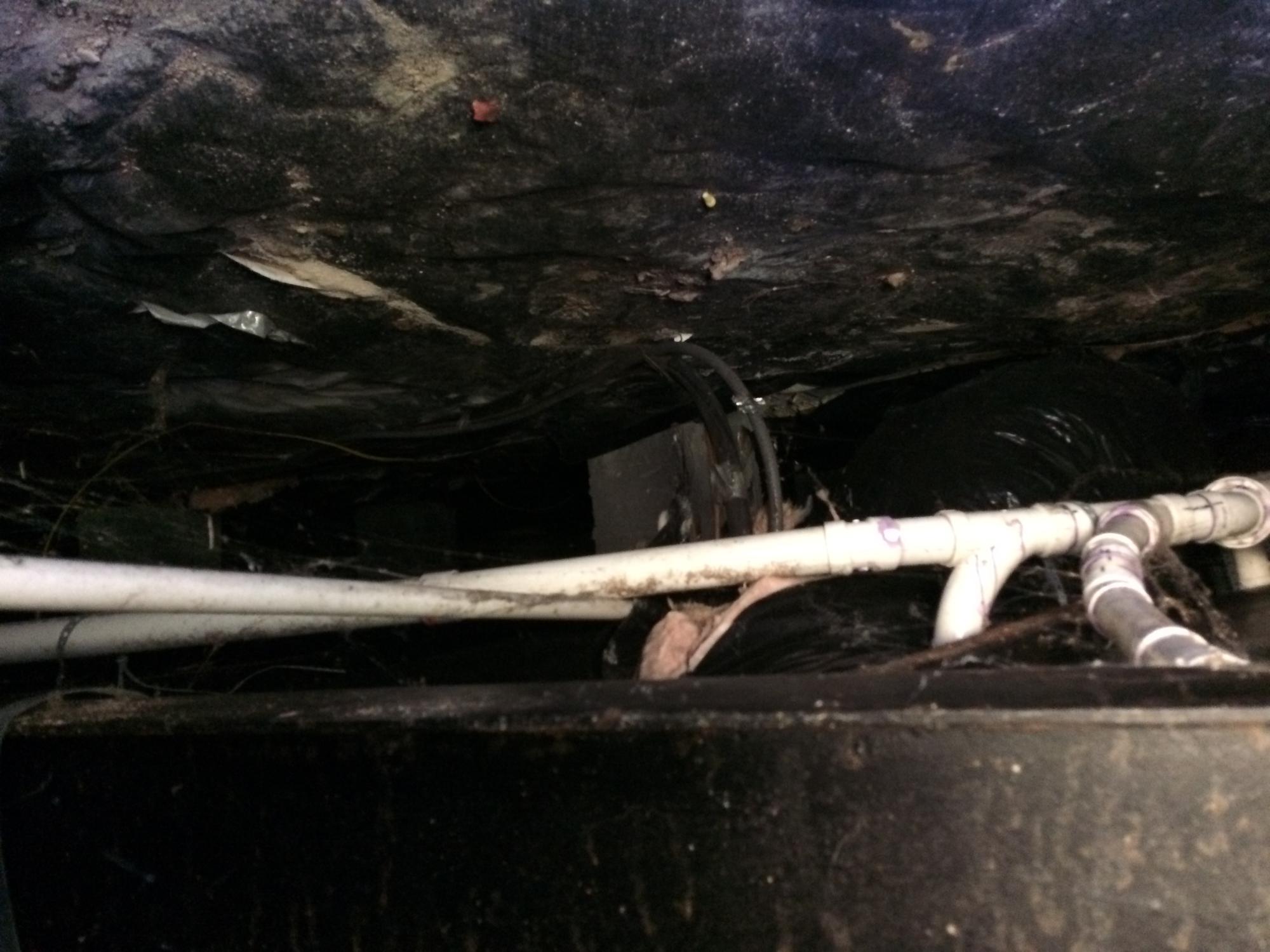

Here we go, have a good one on this topic. Inspected a home today and it is listed as a modular in the MLS. From what I understand, modulars dont have steel frames or underfloor insulation with black vapor barrier: mobile homes do. So, thinking that it might be a mobile home from underneath, it has no HUD sticker and a full attic. HMMMMMM. Is this a modular/mobile hybrid? (Joke). What are your thoughts, mobile or modular?
