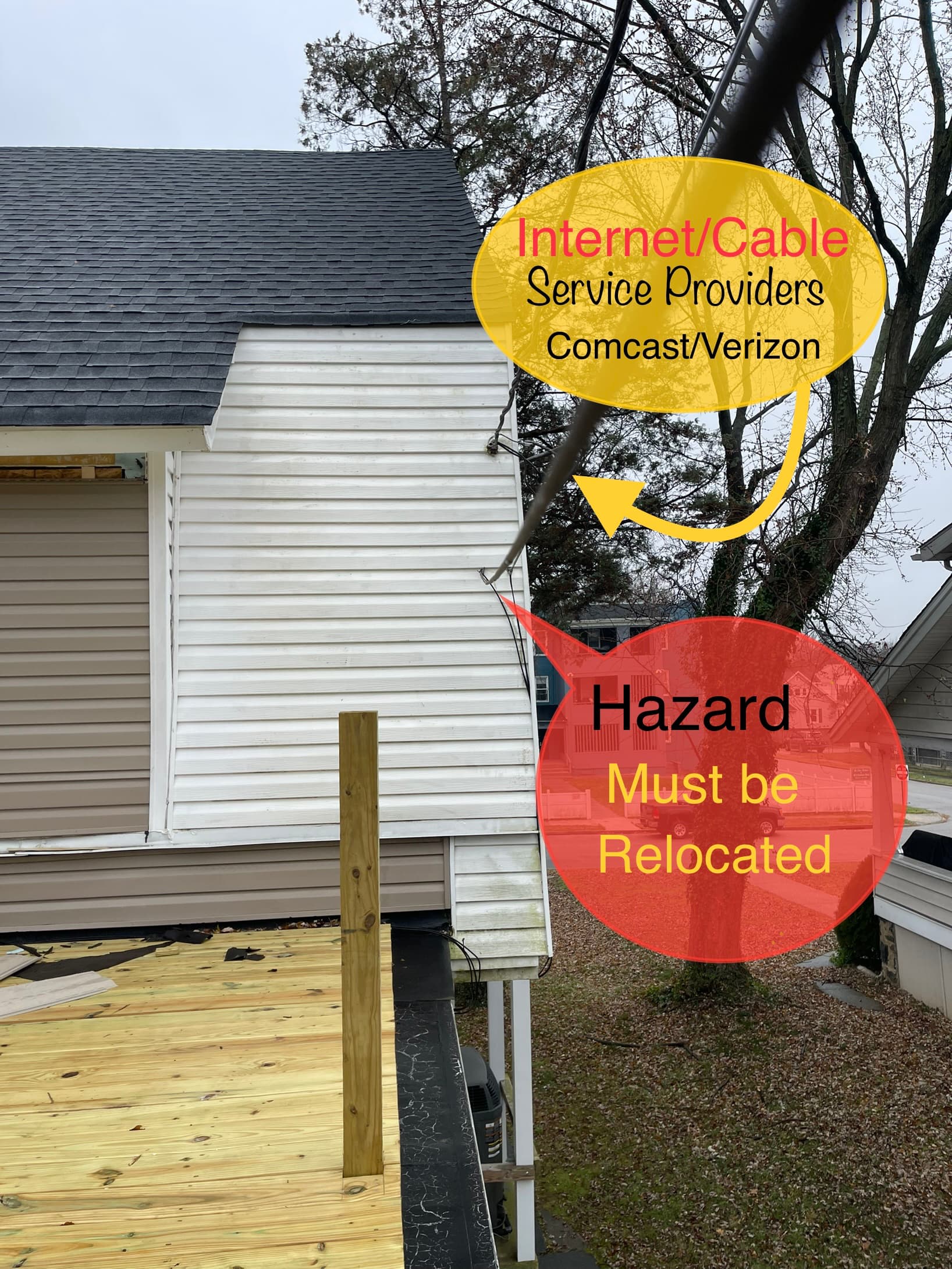

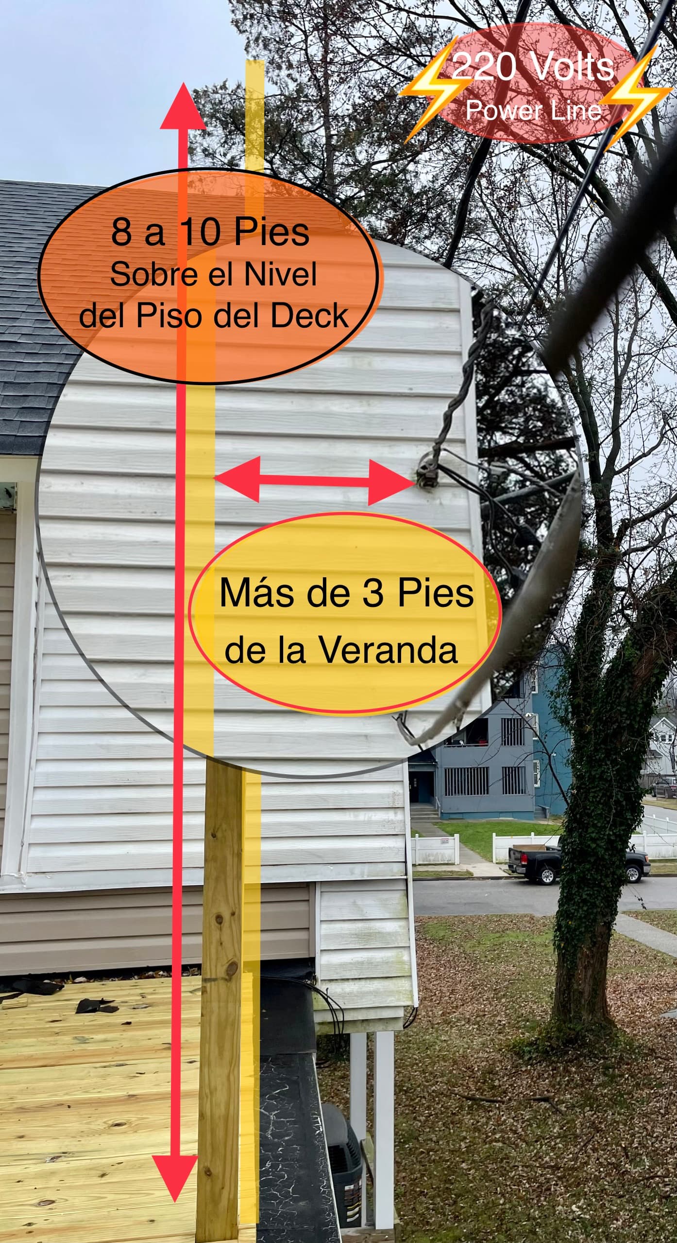

I use Horizon Software. It has the capability to capture & place pictures from you mobile device as well as the iPad directly into the Section or System (Exteriors/Plumbing/Electric/Foundation/Roof and so on. It is ‘Cloud Base’ and the pictures and notes can be transferred to my Laptop directly to empower me to edit the final version of the Report.
However, Nor Horizon or any other software has the photo editing capabilities of a regular iPhone 12 - 13 - 14. That is what I use to enhance my photos before I upload them to the report. Yes! It takes a few minutes to do it, but is well worth it.
It took me short while to master the iPhone photo editing to it’s fullest extend. Again, it is worth it!
After my first 100 reports I found that my clients were not investing the time to read all my boring comments on my reports. I go out of me way to provide some in-depth analysis :face_with_monocle: in my reports, but nobody is reading them.
But my picture and illustrations, oh yeah! They see and engage those 100%.
Most software applications out there enable you to add an arrow :arrow_right: even a circle :o:, but that is it!
Take look at these…
