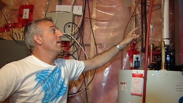

Frank Cappellino, a LaSalle, Ont., homeowner shows where a pipe burst, flooding his basement last fall. (Karen Brady/CBC) Canadians who installed plumbing that eventually leaked will learn Thursday if they will be financially compensated for doing so.

Nicolas Rosati of Windsor was one of the initial plaintiffs. Other area residents have told the CBC their leaky pipe stories. And still others with the faulty brand of pipe are concerned about what might happen.
“If I decided that I wanted to sell my house tomorrow, how am I going to do that with defective plumbing or possible defective plumbing in the house?” LaSalle’s Mark Hicks said. “The value of my house is not going to be the same as it would be if I had copper [pipe] in the house.”
Walt Zarzecki also has the potentially leaky pipes.
“I have to worry about coming home; that there [may be] water in the basement,” he said. “Right now, I don’t have have any signs of any leaks or discolouration in the lines but they’re saying if you don’t have, you will have.”
