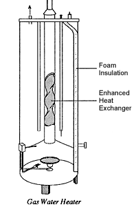

    High Efficiency Gas Water Heaters
High-efficiency gas water heaters have several features that reduce the cost of heating water. First, the tank walls have higher levels of foam insulation. Secondly, instead of having a standing pilot light, a high-efficiency model utilizes an intermittent-ignition to reduce the time that the pilot light burns. The intermittent-ignition device provides a spark to ignite the pilot flame only when needed. Finally, heat exchanger efficiencies are improved, allowing heat from the gas burner to more efficiently and completely heat the water in the tank.
What To Look For
Efficiencies of water heaters are expressed by a number called an Energy Factor. Units with an Energy Factor of .60 or higher are considered energy efficient.
