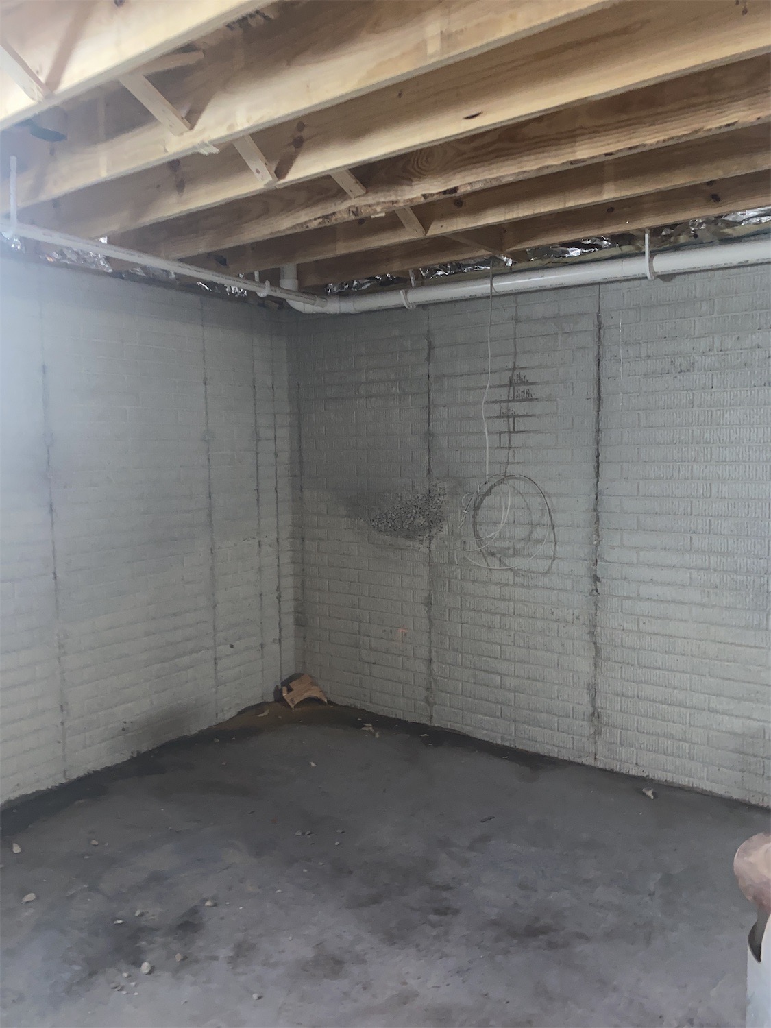

Need help on this one
Can anyone help me with this one?
Cold joint.
I call this honeycomb which is poorly mixed concrete. I do not typically consider it a problem unless the aggregate is loose.
This looks wet
looks like sloppy work filling the forms from here…
Thanks everyone.
No vibration of concrete while pouring…no problem unless deep and/ or loose gravel like Brian said.
I ran my hand across it and some of them were loose and some fell out. Observe and report.
