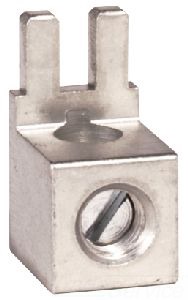

Although electrically it’s probably fine it’s not code compliant. There are lugs made specifically for the purpose of connecting a larger conductor to the smaller holes in the bus bar.

I would go with 110.3(B). I don’t think that you’ll find a manufacturer who lists or labels a bus bar for terminations like the one in the photo.
If it part of the UL listing then it will be a requirement of the manufacture simply because the UL Standard will be the AHJ in the requirement.
Thanks guys, it’s always good to know where to point when an agent tries to argue with a report.

*110.3(B) Installation and Use. Listed or labeled equipment
shall be installed and used in accordance with any instructions included in the listing or labeling.

The stranded SE neutral cable is split up and terminating at different screws at the neutral/ground bar. Some of the wires are Loose at the termination point (screw). The neutral must terminate in a single connection; All conductor strands must fit into the (same) terminal.

So I will tell you from a “Manufacturers” prospective. The lug must be rated and evaluated for it’s intent. Anything other than the investigated intent is NOT COMPLIANT. As stated, there are lugs designed to equalize the distribution of current onto a listed and evaluated lug…However, always ensure that the lug being used is also listed and evaluated for it’s own use as well.
