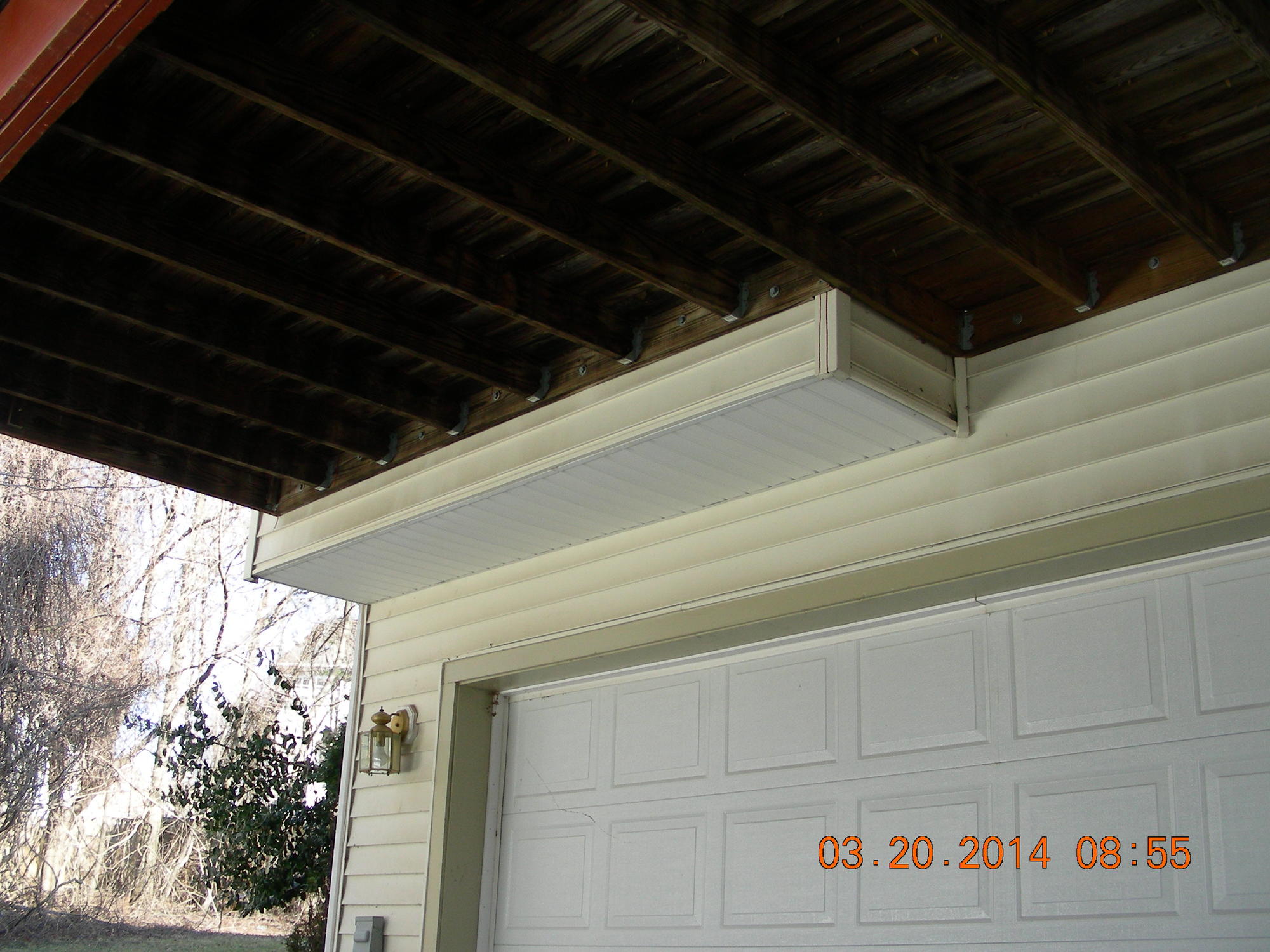

Yes, I would document this as a defect, but I would’t get all worked up about it. At least it’s not a ledger face nailed to a cantilever.
I see those fairly often as well:
This photo is representative of a whole neighborhood of identical town homes less than 20 years old. Of course its called New Town.
None of the ledgers are flashed.
