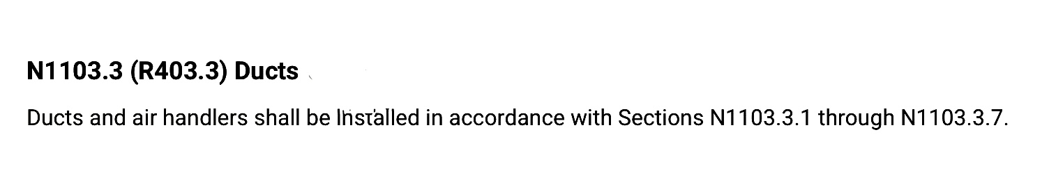

Good idea. Here’s the 2024 IRC reference:
N1103.3.3 (R403.3.3) Ductwork located outside conditioned space.
Supply and return ductwork located outside conditioned space shall be insulated to an R-value of not less than R-8 for ducts 3 inches (76 mm) in diameter and larger and not less than R-6 for ducts smaller than 3 inches (76 mm) in diameter. Ductwork buried beneath a building shall be insulated as required by this section or have an equivalent thermal distribution efficiency. Underground ductwork utilizing the thermal distribution efficiency method shall be listed and labeled to indicate the R-value equivalency.
This section requires that all supply and return ductwork located outside of conditioned space, regardless of size, be insulated to R-8 or R-6 depending on duct diameter. Ducts buried under a building either must be insulated to these requirements or be labeled to indicate an equivalent R-value.

can you show me where this is in the IRC?
