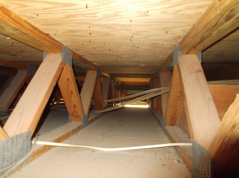

I recently inspected a very intricately designed 1980 home with Geo Thermal. The house has a main floor and a full basement built with engineered floor trusses. (high tec for 1980?) I pulled up a floor register on a hardwood floor to discover no duct work. I at first I thought it was a cold air return. I found out that this is the heat source. The owner/designer has charged the entire floor cavity with warm air. (Keep in mind this is geo thermal, so no risk of overheating, fire or even carbon monoxide) Where ever he wanted heat, he simply cut a register into the floor or ceiling. He says this works well, and keeps his floors warm too.
This is the first time running into this configuration, and it took me a minute to wrap my head around it. Have anyone else seen this or have anything to add?

The blower simply blew into the floor cavity, roughly 125 degree air (I didn’t actually measure the air temp, but the plenum above the furnace was nice and warm) It had a natural cold air return through the stairwell and open balcony. Almost all the doors an the house were Louvered to improve air flow.
This was very quiet, (and once the floors are warm) I would think a very even heat. I could also see moisture as less of an issue in the floor cavity.

*No ducting present. Furnace blows warm air into the Floor cavity, and then subsequently out of the registers. Cold air return is natural though the louvered doors, stairwell, and balcony. This is an irregular but not necessarily an unsafe method of heat distribution considering the heat is geo-thermal. Installing ductwork would help improve the efficiency of the air flow system, but would change the “warm floor” feeling. *
How does he get the heat to travel across the joist bays? I guess any heat that is loss downward enters the basement. The rim should be sealed and insulated well to prevent heat loss that way. Also any wire or pipe homes would need sealing to prevent the air blowing up the wall cavity and into the attic. It’s a interesting to say the least.
Very good point Robert, I obviously couldn’t see all the rim joists, but they were insulated where I could see. These were engineered floor joists, about 24" thick and made of criss-crossing 2x4’s. Heat would flow just fine sideways.
A shot from below the floor through a heat duct.
