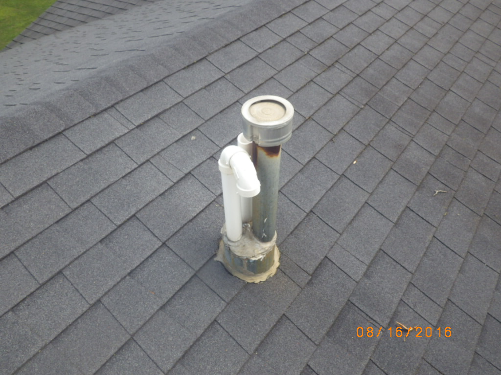

I see that often and is fine but agree that install is sloppy. Here’s one that’s not ok. The pvc pipe was damaged as a result of the heat from the metal vent. Just thought I would share.

Some manufacturers allow it. A condo may have a short vertical rise so falls within parameters. Many possibilities, so if you see one that suspect, research it on a one by one basis.
From a couple of months or so ago, furnace was 2 yrs old if I remember right

Well there you go. That manufacturer for that model allows it.
I have never, ever heard that you cannot vent vertically and I would love to see some documentation proving otherwise.
I usually see them vent through a side wall. Have not researched the reasons why or if they can vent vertically. I suspect it may be more distance rather than vertical vs. sidewall.
I would check manufacturer installation recommendations for the specific model.
