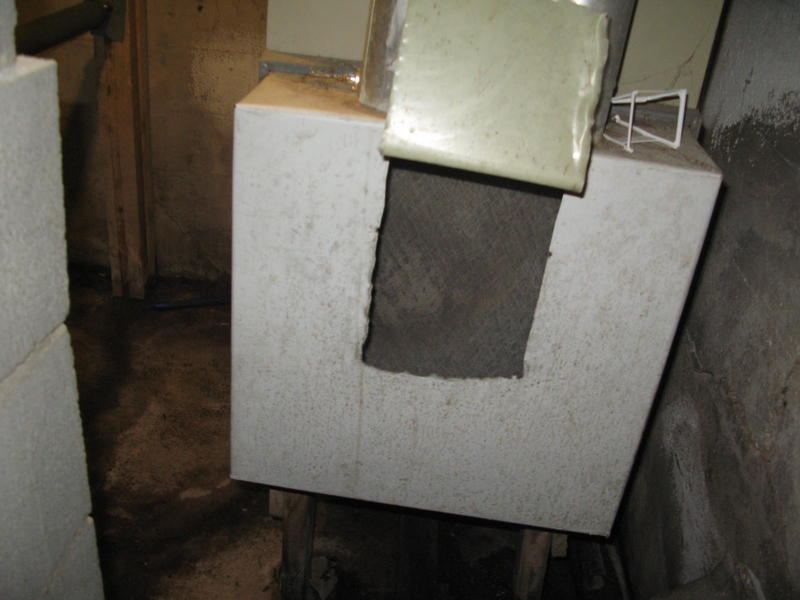

Foundation is being kept from collapsing by a horizontal telepost and a 2 x 4 between the chimney and the foundation wall. Foundation is still moving which in turn crumbled the chimney. This was allowing water into the basement and the only ‘fresh’ air in the home was a hole they had cut into the furnace duct which circulated the musty air from the basement through the whole house. I know the smell alone would win me some kind of prize. But they had thrown a couple of air fresheners in the furnace to help with the smell. :twisted:

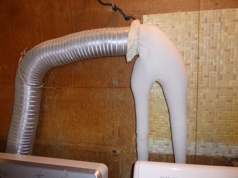

Dryer vent in garage with some type of pantyhose or leggings attached as a filter, instead of venting to the outside of home. Very interesting when dryer is turned on as shown.

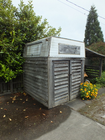

A customer actually asked me to inspect this shed.:neutral:
Here is the pic…
Description? Not installed per Manufacturers Instructions? ;):mrgreen:

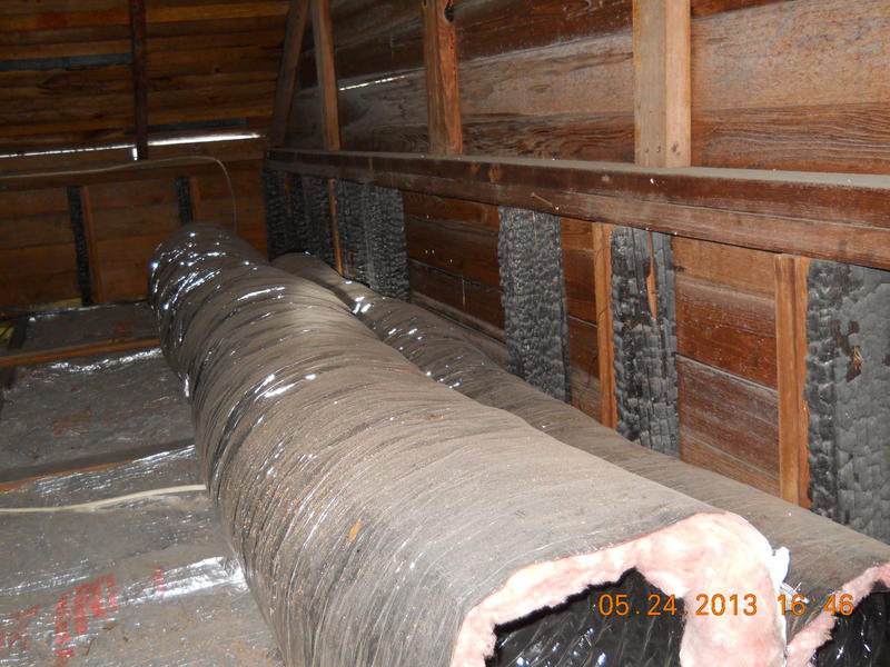

This home was built in 1895 and the complete roof was burned off back in the 60’es. I still don’t understand that after doing all that work they didn’t replace all this burnt lumber.
I just found out that the guy buying the house I showed pictures of got a $6,000 discount on the house. I almost fell over when I heard that he still went through with the deal. When I met with him to discuss the home I told him he needed to get an estimate for the cost of repairs and decide if it was still worth it for him to buy the home. I guess he decided it was still worth it. Go figure.
