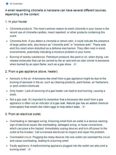

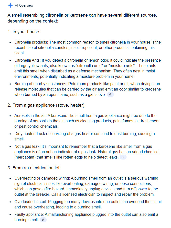

This is great Jeffrey! I should have known to check AI. I appreciate you!

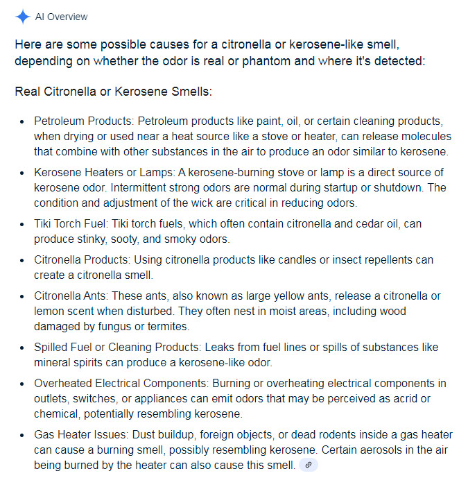

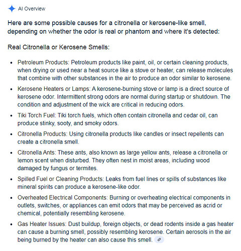

I didn’t include the ‘Phantom’ causes as multiple persons observed the smell… so here is some elaboration to the ‘real’ causes…
