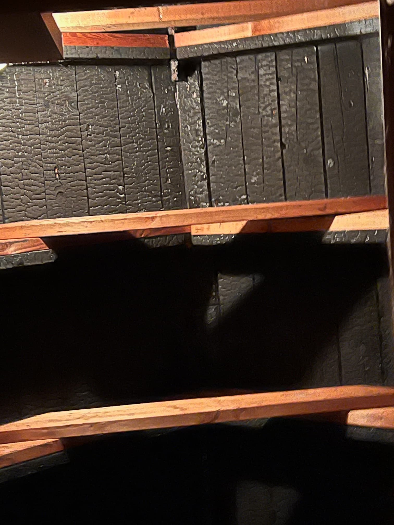

Looking for advice on how to proceed with re-roofing a roof that experienced fire damage in the 70s in regards to maintaining structural integrity.

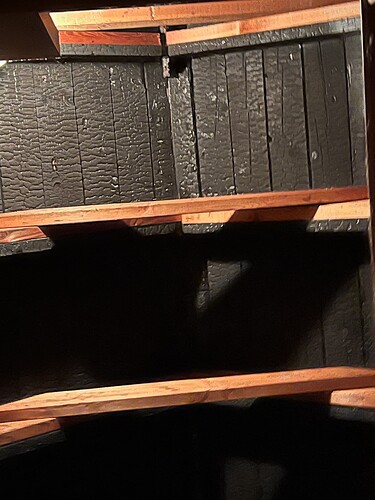

10 years ago, we bought a small ranch at a good price however, at the time that we bought it, the roof was charred on the interior from a fire that occurred in the 70s. The affected supports were sistered, and our inspector (who I believe was an engineer) was not concerned about the integrity of the roof at the time - he called it surface charring and felt it was adequately supported. The sister supports have an additional support across the top (pictured). The ridge beam is so charred that it completely is missing in parts, however the inspector felt it did not carry much structural concern.
Now, we need a new roof in regards to shingles (no leaks knock on wood). We can have ice damming that is occurring in one portion of the house and the roof in general has not been touched probably since the fire in the 70s and there are two layers of shingles. From the interior the cedar appears to be disintegrating a bit and can be soft to the touch in spots.
Any advice on what the best route would be?
One person said everything including the sister joints have to come off and I need to completely redo the roof and support.
Two other roofing companies said they can keep the support and just put plywood where the planks are and that they do not need to put a new ridge in. This is obviously significantly cheaper and how we would prefer to go IF structurally sondu .
There has not been one consistent piece of advice. We actually had two very reputable roofing companies say they wouldn’t touch it for fear that it would require more work than they saw, and that town might need to come in and grant permits after they rip open the roof.
Anyone have advice? I attached a few photos. Can add more. I am concerned for the next buyer passing inspection after a re-roof (we hope to move in the next year or so and feel this must be taken care of to sell).

Charred Wood cross section
First, based on the photos, the damage will be a huge red flag to any buyer.
Second, get a structural engineer to evaluate, generate design plans and then execute with a qualified builder/general contractor. Keep all documentation and permits to pass along to the next buyer.
An accurate assessment cannot be made from a few picture viewed online.
I would recommend a Structural Engineer to assess your specific situation.

Please add more images. Try to include every structural component that was charred. Some images of the eave and connections to the eave and raked ends or gables.
I tend to agree with the roofers to sheath the roof atop the planks, with 5/8" plywood, to strengthen and fortify the roof structurers rigidity, but those are my thoughts.

IMO, adding a layer of sheathing directly on top of the original existing “charred” and “failing” lumber will only add additional, significant weight to the system and contribute to it’s expedited, eventual failure!
Adding that much weight to an “undamaged” system is oftentimes not recommended, as it typically is not designed for that much additional weight!
Again… Do Not add to the conditions that are already causing concern, unless you are hoping for imminent and catastrophic failure!
I question why charred rafters were being used as support for the new sistered rafters.
THIS… vvvvvvvvv …I see this often. Usually a contractor ‘picks’ the char and announces that the ‘char’ is on the surface only and the interior of the lumber is able to hold nails/fasteners… aka. contractor scam!!
IMO once you see the blocky char appearance you have lost 10% or more of the strength. I would have recommended tear the roof off and replace.
