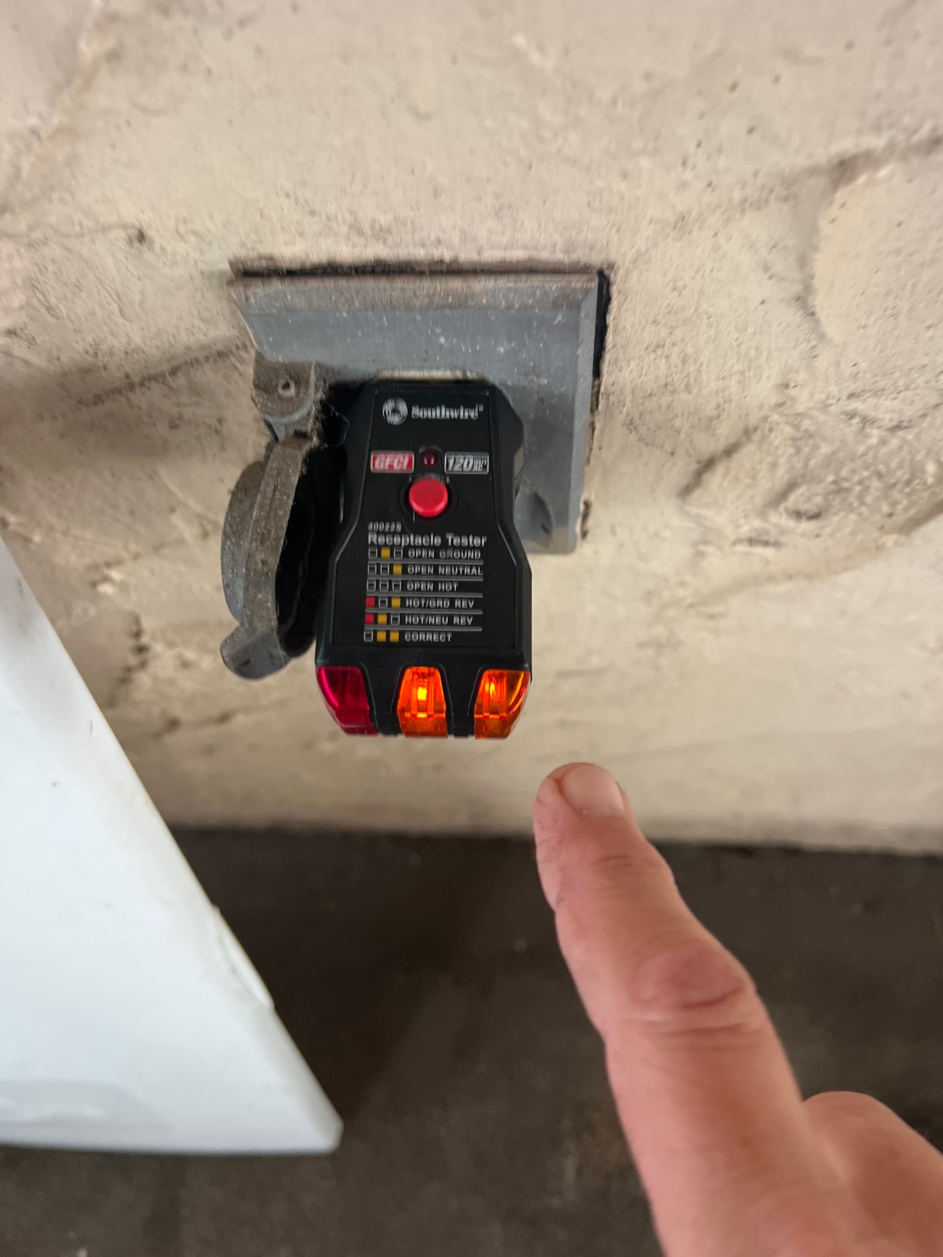

Anyone ever see this shown in the pic? GFCI tester trips the GFCI breaker as it should, but the red light above the test button stays on when the button is held. Even more interesting, other outlets on the same GFCI breaker do not show the same phenomenon. Seems like there is some back feed coming into the outlet in question.
Hi Jeffrey, appreciate your input. However, not entirely applicable in this case. The caption you highlighted is relevant on non-GFCI circuits/outlets as the light will stay illuminated. If you take your tester and try it on a GFCI which trips, the light will be completely off (usually - excluding this odd case). After all, when the GFCI is tripped there should be no power to illuminate the light. As noted, this is on a GFCI breaker, and other outlets on the same breaker behave as expected where upon tripping the light is not illuminated.

Hi Jeffrey,
Yes, I did fully read the material. I had actually found all that before even posting. I have already contacted Southwire via phone which was voice prompt hell, and email. And yes, it is a cheap POS, but a great throw away and cost effective when damaged.
However, here is the point - You need to think through this a bit; You press that button, the GFCI breaker trips. There should be no power to illuminate that light. So, your next thought is something is amiss with the breaker or the circuit. However, when testing other outlets on that same GFCI breaker, it trips, and the light is completely extinguished. You need to really follow the steps to recognize it’s not a tester issue, something else weird is going on.
Did you check it with another tester to see if there was a similar result?
