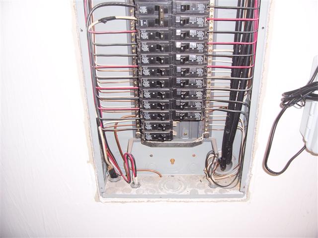

This would rate as one of the cleanest/neatest panels I have seen to date.
Looks like the work of Paul A.

That is too excellent! I’ll bet all the wall plate screw slots are all perfectly horizontal, too. What’s the 4 pole main breaker all about? I haven’t seen that before.

Grounding issue with wires leaving the enclosure at the top and the bottom

Don’t think Paul would use a nail hole(zero connector too) for a ground wire.

James, that is a common breaker setup on Siemens/ITE type panels. Each 2 pole breaker feeds one bus at two contact points.
Richard, what grounding issues do you mean?
Tom, I don’t see the GEC going thru a nail hole. Panels today come with 1 or 2 small knockouts just for the GEC. Maybe that is what you are referring to? Can’t really see how the top one exits, but I can’t see any violations.

Actually it is a rather neat panel…I would only have a FEW complaints if my guys did it.,…
1 - I don’t like the conductors bending down and straight back up at the top of this panel…I like them routed to the back corners and neatly ran as tight to the back sides as possible…but thats just me.
2 - No problem with those GEC’s going through the approved openings next to the Concent. KO’s…not a problem at all…I would have done the same thing.
3- Now…I have a habit on my “Grounded” conductor of using (3) wraps of WHITE tape on it…just my thing…you know…my signature…:)…ok…I know…I Know…
4 - I don’t nearly leave as much conductor on the wires that terminate in the buss bar…but again thats just me.
5 - WOW…they must have had a FIGHT getting the conductors into the box as the jackets on the SE conductors are beat to death…
Overall…I would say it is neat compared to some I see…BUT it ain’t as neat as one of mine…yep…thats my EGO coming into play…:slight_smile:

Can you give me a reference to what manufacturer directs you to use 1/4" holes for such use? I was taught those are nail/screw holes, since using them for anything else without a connector is a violation. References: 2005NEC 314.17, if not directed by manufacture for GEC then 2005NEC 110.3B, and then of course the infamous: 110.12

It has been posted on here MANY times that the smaller 1/4" holes located next to the KO's for the se conductors are perfectly allowed for the GEC via the Manufacturer.....they are not mounting holes, weep holes......they are designed with a KO that must be removed and nearly every EC I know uses them for the GEC.

lol…ok…well…I can’t seem to find the image from the manufacturer but I will look…FYI…I don’t see it as a violation at all…and it is placed their by the manufacturer for that intent…are you saying a WEEP hole is CLOSED until it is opened?
These little holes beside the SE KO’s is designed for the GEC…we are talking about two different things here…call it dejavue…
FYI…do you think the little BLACK button connectors are approved for this application as well?
No never called it a ‘weep hole’ besides, I don’t know of any manufacture that calls them such, since they say for wet conditions use a rain tight box. :wink:
I called them nail holes, since I use a small nail, or awl to knock them out. Many times they are ‘plugged’ and need the filler material(uncut part of the box) knocked out.

Hey BUD…its your inspection…:slight_smile: but if I get called out by a HI ( wearing my electrician ) hat because the GEC is running through one of these openings that I have defined above…lol…hate to be the HI when I explain to the client they are incorrect and that the GEC running through that openings is perfectly fine…:slight_smile:

Guess what…I used the little KO for my GEC on a 400A service just the other day…guess what…PASSED with no problems…:slight_smile:
