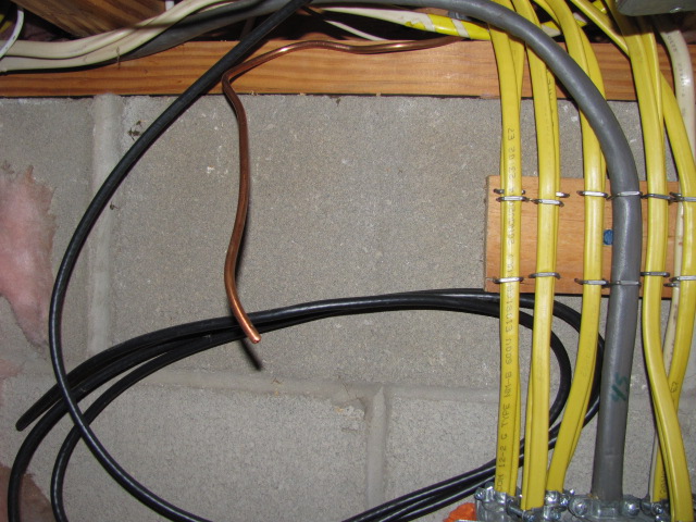

This panel appears to be wired as a sub panel. I did not locate any other disconnect. The original ground was not connected. Very neat wiring, but why separate the neutrals and grounds? Opinions appreciated.

Thanks to all. Only thing missing is a grounding source. The grounding conducter was coiled above the panel.

We can call it a neat and job with Pride…However, if he(or she) has not finished what they have started and connect the GEC to the Grounding Electode(s) then he is NOT done and in my mind unprofessional. But in all fairness maybe they are not done yet…
