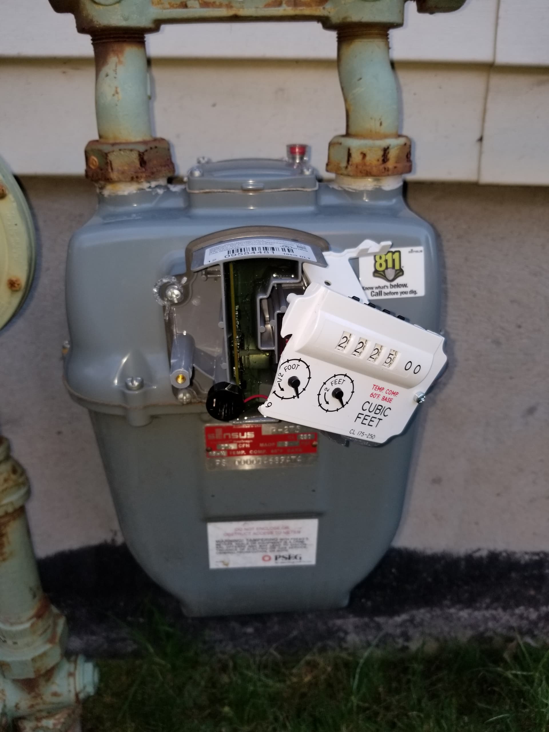

Looking at some of the photos in this thread the swing arm should be the least of your worries. It is much more likely that a landscaper will crash into the gas piping with a big heavy machine yet no one sees that as a potential issue?
It is a 55 an older community, I believe that they have a company service the landscaping. I have not thought of making a comment for that.
The second photo is from my own home where my landscaper smashed only the metering portion of the meter. It certainly could have been worse.
