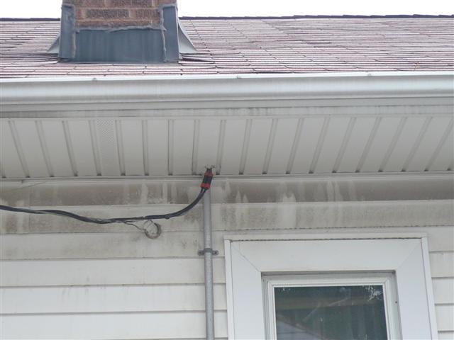

Where is the Serice head & mast? It was not visible at the exterior, roof & attic. It must be buried in the soffit.

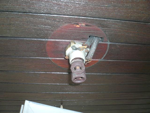

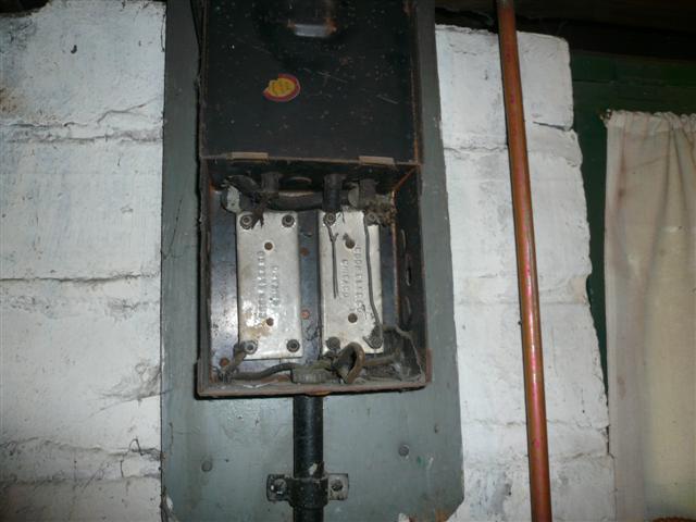

Also this 1924 house had numerous original wiring with numerous exposed connections.

It must have had an open soffit before the aluminum siding contractor got there. When the insulation on the service deteriorates, the siding will be hot.
