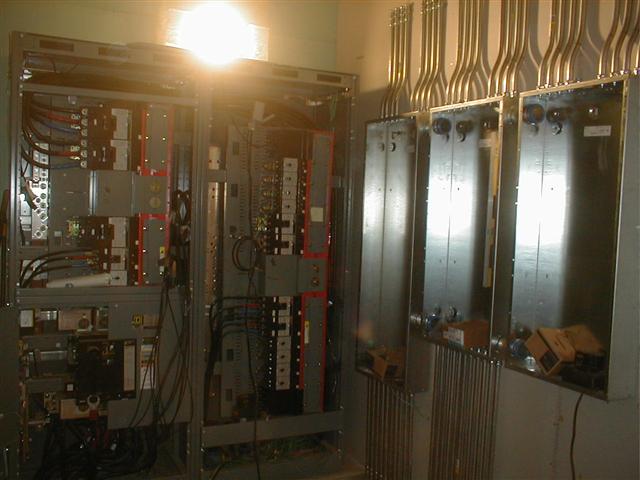

I also did 95 percent commercial and industrial. I never really liked doing residential wiring. My favorite job was probably a grocery store I did. There was more crammed into it than most factories I have wired. I also ejoyed remodeling 2 hospitals. The regular, emergency, critical, and life safety, branches of power made it very interesting. Not to mention all the generators.
I also did a data center for a bank. It was also crammed packed.
Here are some pictures from the last job that I did. THis is the job where I injured my shoulder. I will be having my 3rd surgery in January. Yes, I am dredding it already.

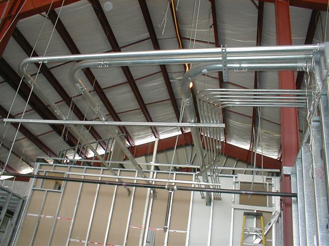

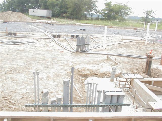

OOPs, left out the picture.
and some.
Another weather head.
That’s quite a drip loop. A drip roller-coaster, rather. I do note that the nylon outer jacket is coming off the conductors, but that is permitted. I have a letter somewhere on my computer from Southwire, a popular wire and cable manufacturer, that states that this is normal, expected, and permissable. The nylon outer jacket is installed over top of the conductor insulation to protect the conductor’s insulation during installation. If it survives beyond the installation, that’s okay. If it comes off by some means later on, that’s okay too, as it already did it’s job.
MAN…all that bending of conduit is giving me a “Benfield” flashback…CLICKING MY HEELS and saying…No place like home…No place like home…ACK…
Won’t catch me bending pipe anymore or running 4" above my head…not this fella…
Nice runs BTW…very impressive.
Me neither on running the 4inch over head. I had days were I would run 3 or 4 inch all day overhead. Have also run 1-1/2 up the side of many grain elevators, and water towers. O happy days.
