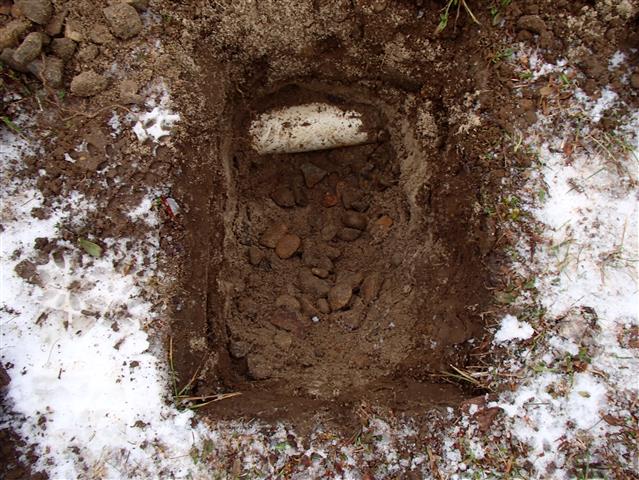

Still at it even though there is 30 + inches of snow on the ground. Here is a 26 year old stone and pipe system set up in a butterfly configuration, almost like two EDA’s, one to the left of the D-Box and one to the right. Each had six rows of laterals. When I arrived onsite I immediately noticed a large area where the snow had melted or not accumulated, at first I thought this was where the tank was. By using the plan I obtained from the town and taking a few measurements I realized this area was the beginning to middle of the EDA.
I dug one inspection hole in this area and it was completely saturated and the hole filled with effluent. The second and third hole’s were dug to the left and right and looked good. No staining in the material and no standing effluent.
I conducted a load test on the system which accepted water fine with no back ups. So whats going on? Why is the beginning of the EDA wet and the middle and end dry?
Since this system is 26 years old my opinion is the EDA is in it’s later stages of life and replacement should be expected (my recommendation to my client), but, there is always a chance there could be a problem with the D-Box, possible corrosion, broken pipe, ETC. I was unable to locate the D-Box due to the amount of snow and ground conditions but in the end there is significant saturation of the EDA and that will have to be removed, at that point you might as well replace it.
Notice the amount of black septage on the stones that were removed from the inspection hole. This has been an ongoing problem for a long time and I suspect this area stays saturated all year long.

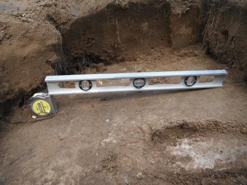

Recently did a septic inspection on a vacant house (length unknown) and as shown in the attached overall photo, I noticed a depression in the yard where I dug up where a tank that was not directly out from the sewer line that left the house at the very left of the photo.
The first thing I noticed was the top of the tank sloped 1 1/2" per foot, back towards the house. Water was freely flowing from the house and from the inlet photo, it was apparent to me that the tank had backed up in the past, based on the sludge above the inlet line. Water level in tank was well below discharge outlet but when I noticed the perforations in the sides of the tank, I realized this was a dry well system and also noted there was a second tank that the first one discharged into when it reached that level.
Since it was obvious to me that this dry well tank, with a heavy layer of sludge in the bottom, had been completely filled to the top with floating sludge in the past and, even though the water level had drained out into the soil while the house has sat vacant, I my opinion, with the back slope on the tank alone, I informed my client that the system had a major problem, it may work for a while after they moved in but would soon be backing up and be in total failure, recommending a septic installer investigate further.

Hi Gary, evidence of back ups can be from a prior clog which will leave behind a scum layer. The best way to evaluate a drywell is to dig down along the down sloping side of it as far as you can go. You need to look for staining in the stones that surround the drywell as well as standing effluent (may not be present due to vacancy). Once this is completed I would do a heavy load test on it to see how well it drains or if effluent backs up in the inspection hole. Sometimes more than one hole should be dug to be sure.
Also, I would stay away from predicting failure and in this case recommending a septic contractor to further evaluate would have been the prudent thing to do.
Hope this helps. Not sure if I understood your post completely, was there one treatment tank and two dry wells? If so, a second or serial drywell may have been added to make up the volume of the first one, if saturated.
Drywells can be very effective EDA’s but the problem is they’re more of a vertical dispersal system rather than a horizontal system. Sometimes, the bottom of the drywell could very well be in the water table, in NH this would be considered a failed system by state standards, even if working.
