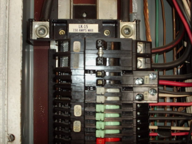

Question from inspection photo.

How many other things can you see wrong in this picture?

Some airhandlers with aux. heat strips of 15-18kw can have a 90amp 240volt circuit breaker. 10kw strips use 50-60 amp breakers.
Also a large commercial style oven in an expensive home that might use a 90 amp breaker.
correct answer could actually be A or C
A 90 amp C/B is not automatically wrong until you check the rating of the load wires and the appliance.

I agree with Bruce.
What else is wrong? It appears as though they’re using neutral white wires in place of red or black hot wires.Although they did indicate with elec. tape that the white wire should be considered black or hot. I’d be interested in seeing the neutral bus bar.
Originally Posted By: ckratzer
Addition to last message.I’ve worked in this type of box before.This type will try to kill you because the neutral bar is under the terminal edge of the breakers which is a really poor and dangerous design. icon_eek.gif

My inside panel has 100 amp breaker for the heat pump. The panel for the heat pump has 100 (main), 60 (a/c) and 50 (heat) amp breakers.

For me that is the first time that I have seen a 90 amp breaker. It was serving an air condenser that was rated for 40 amp.

It’s a Zinsco. That’s what’s wrong!!

As you can see from others comments there is a possibility of several correct answers. When I first wrote the question I thought the correct answer would be E. But I stand corrected. This experience has shown me how difficult it is to write a new exam too take the place of what is available now. Gerry thank you so much for the time and effort you are putting into writing a new exam for NACHI.
