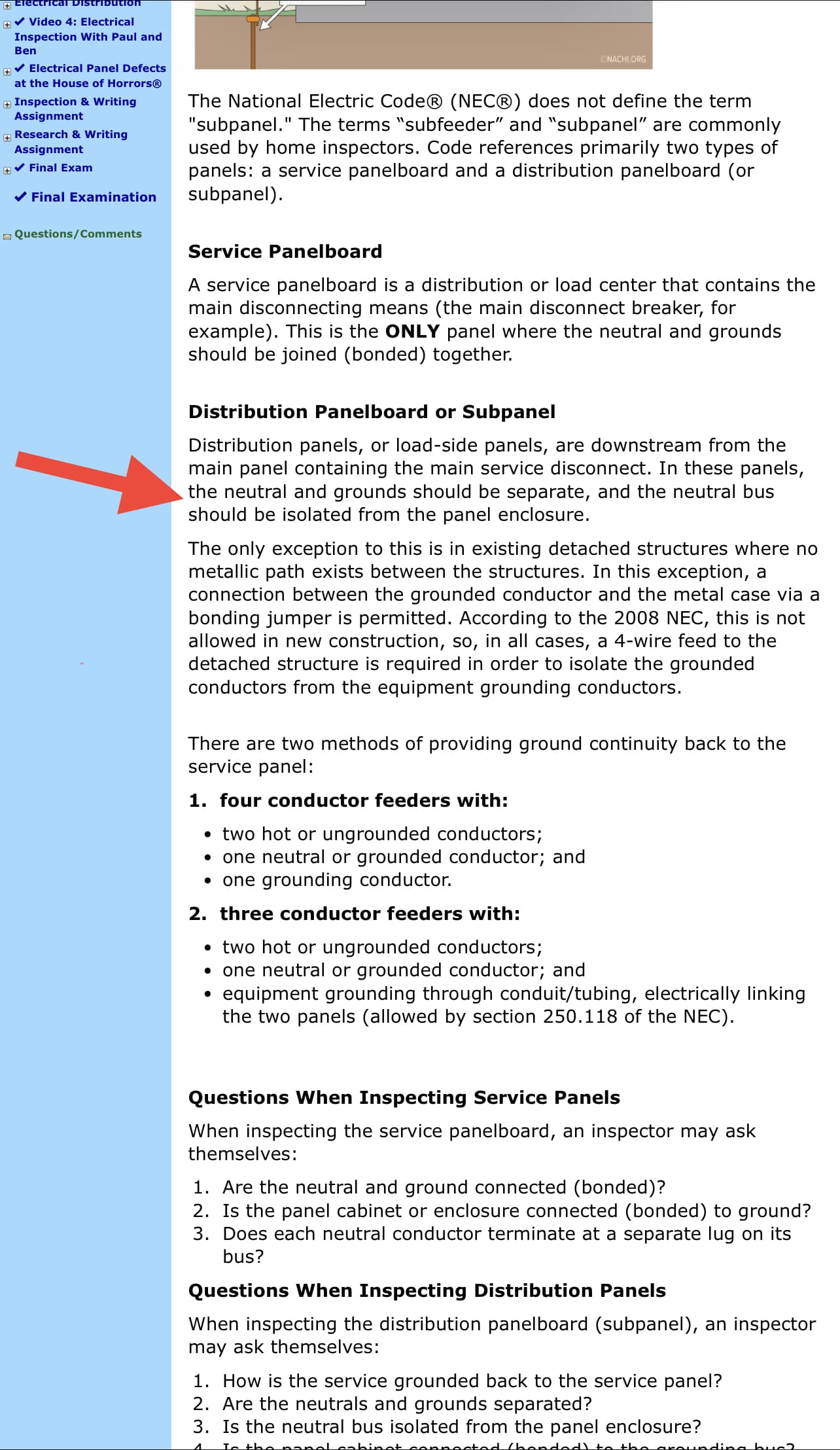

Can someone please explain the following question (questions an inspector should ask themselves during the inspection) included in the Subpanel information from the Residential Electrical Inspection course?
Is the neutral bus isolated from the panel enclosure?
Thanks!

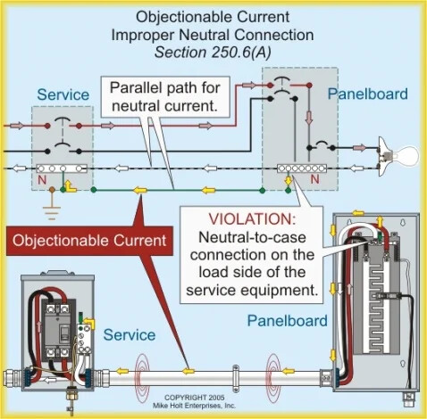

Here is a description and graphic from Mike Holt’s forum which may be helpful. The term to remember is objectionable current (basically current in the wrong place).
“If they’re connected at both ends [service and subpanel] they’re in parallel which makes the EGC system (included EGC’s, metallic raceways and enclosures) all current carrying conductors. The EGC should only carry current under fault conditions.” Forum Moderator

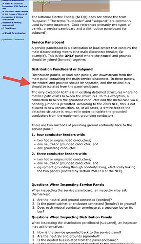

Here’s the source of the OP’s question from How to Perform Residential Electrical Inspections Course, Grounding and bonding, Panels and Subpanels…
Throughout the course, the terms “isolated” and “floating” are used repetitively, with no clear explanation of what those terms are supposed to mean.
I agree, “isolated” is probably not the best word because it implies no continuity to the panel. Would “insulated” be a more appropriate word?
First, the question in the course is a valid question. What’s important is what the course says the correct answer is The correct answer is NO. If the course material says anything other than an unequivocal NO, it is wrong.
