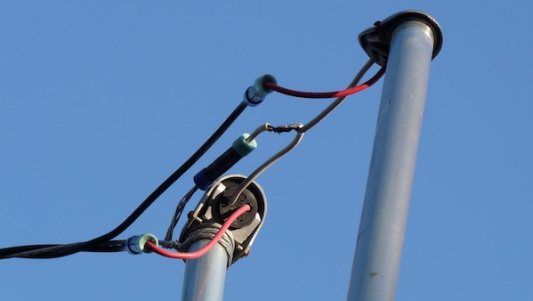

This is the overview for the Mexican Residential Electrical course, now at 22,500 words and probably 85% complete. Their standards are identical to the copy of the 2002 NEC I have with me. Anyone care to comment?
Anyone want to review the course material for accuracy?

I would take a look at this part:
The current flowing in a two wire circuit is equal in both the ungrounded and neutral conductors and alternating at 60 times a second. The way that it’s written it sounds as if the current is flowing out on the ungrounded conductor, some of it being used up and then some different amount is returning on the neutral conductor.

Corrected version:
                 **1.    ****After passing through the home electrical system, some electrical current will return to the** **CFE power distribution cables.**
When electricity is consumed at a branch circuit termination (like when an electric light is turned on), a connection is made between the ungrounded (hot) and grounded (neutral) conductors in that branch circuit and electricity flows through the circuit. 127v of current will enter the light, and after passing through the fixture and bulb (the load) 127v of current will flow back through the neutral conductor of that branch circuit to the service panel and from there to the CFE power distribution cables.
I was told that this neutral shared between two adjacent services was not really a problem because voltages are lower in the neutrals. That’s not true if the ungrounded and grounded condutors are both carrying 120v (127v in Mexico).

What’s depicted in the photo would be no different than a 3-wire, multi-wire branch circuit (MWBC) feeding two 2-wire branch circuits. In that scenario the neutral will not need to carry any current greater than the imbalance between the two circuits.
So if one were carrying 125v and the other 130v, the imbalance would be 5v and the neutral would only carry 5v? It wouldn’t carry the greater of the two- 130v?
The neutral is not carrying voltage as it is at ground potential.
Post #2 says ungrounded and grounded carry equal amounts of voltage. It’s prtetty well accepted that the neutral is a current-carrying conductor, so I don’t understand what you’re saying, Mike.
127v is standard here in Mexico.
voltage is not carried as it is pressure that pushes the amperage or current or to be exact electrons, The movement of electrons is measured in amperage, voltage is what pushes the electrons and does not flow or move
The above would be correct if you said amps instead of volts.
The neutral is carrying voltage.
A residential electrical system is a loop with ungrounded conductors as supply and grounded as return to the utility equipment (not sure exactly to what). If the neutral service conductor is fused and the fuse blows, electricity, current no longer flows, nothing electrical in the home works although the ungrounded conductors are still energized and so are the grounded up to the point of disconnection.
So on a normally-configured system (normal except for the shared neutral)… if the voltage can be as low as 5V on the neutral doesn’t that drastically reduce the operability of both the systems since flow back to the pole is severely restricted?
Why doesn’t current flowing back to the pole need as much motive force (voltage) as current flowing toward the loads in the home?

It’s not uncommon down here to see three conductors go to three meters (for one house) —one of which will have a GEC and an electrode—installed on the outside of a boundary wall (so the meter reader doesn’t have to enter the property to read the meter). Then three conductors go to a fused disconnect enclosure with three fuses installed, there’s a mass of splices and double and triple taps (on both line and load sides of the fuse) and nothing is color coded.
Just found that out last week after 7 months here that usually one of the fuses is a usually fused neutral, meaning it’s a 2-phase system, except that down here if it’s got one phase conductor, it’s called single phase, two phase conductors makes it bi-phase and 3 phase conductors makes it tri-phase. Pretty crazy eh, to use logical terms when describing an electrical system that seems to have been installed by people with no electrical training.
One tap typically goes to a load center in the house which has it’s own grounding electrode, and another goes to the pool, which also has it’s own grounding electrode, if it’s grounded at all. Nothing is grounded at my girlfriend’s 4-year-old house including the pool and Jacuzzi (which I unplugged).
The house around the corner has one conductor only entering the Weatherhead!
