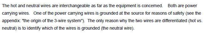

I found the text in the attachment in a book by the American Power Conversion Corporation, apparently now called “APC by Schneider Electric.” It certainly seems to say to me that the neutral is a live “hot” wire.

The neutral does carry current, but it is called the groundED conductor. You can receive a shock from a disconnected neutral.

The neutral carries current, but it is not referred to as a hot. It is grounded and serves as the reference to the hot legs.
Finally, someone admits that the neutral carries current and is not referred to as a hot. As I told my Clients for many decades, “neutral” is a misnomer because it certainly is “hot.”
The neutral is at ground potential in reference to the hots. It is not considered a hot as it is at ground potential. Measuring between ground and neutral should be zero volts. Measuring between hot to ground or hot to neutral should be 120 volts.
It difficult explaining all this without some sort of graphic aid. While the neutral is connected to ground it is not considered hot. If it were to break while you were holding it (and depending on which side of the break you are on), you may be in to an unpleasant experience, because the electric current needs to get back to its source and need a complete circuit (path) to do so. You holding on to the wrong side of the neutral just provided that path…through your body.
The use of the term a “hot conductor” means that it will have a potential to ground so if you touch a hot conductor while you’re grounded then there is a shock potential. Although the neutral is a current carrying conductor under normal conditions it is not a “hot conductor” because it’s potential to ground is zero and not a shock hazard. Realize that “hot conductor” is a slang term.
