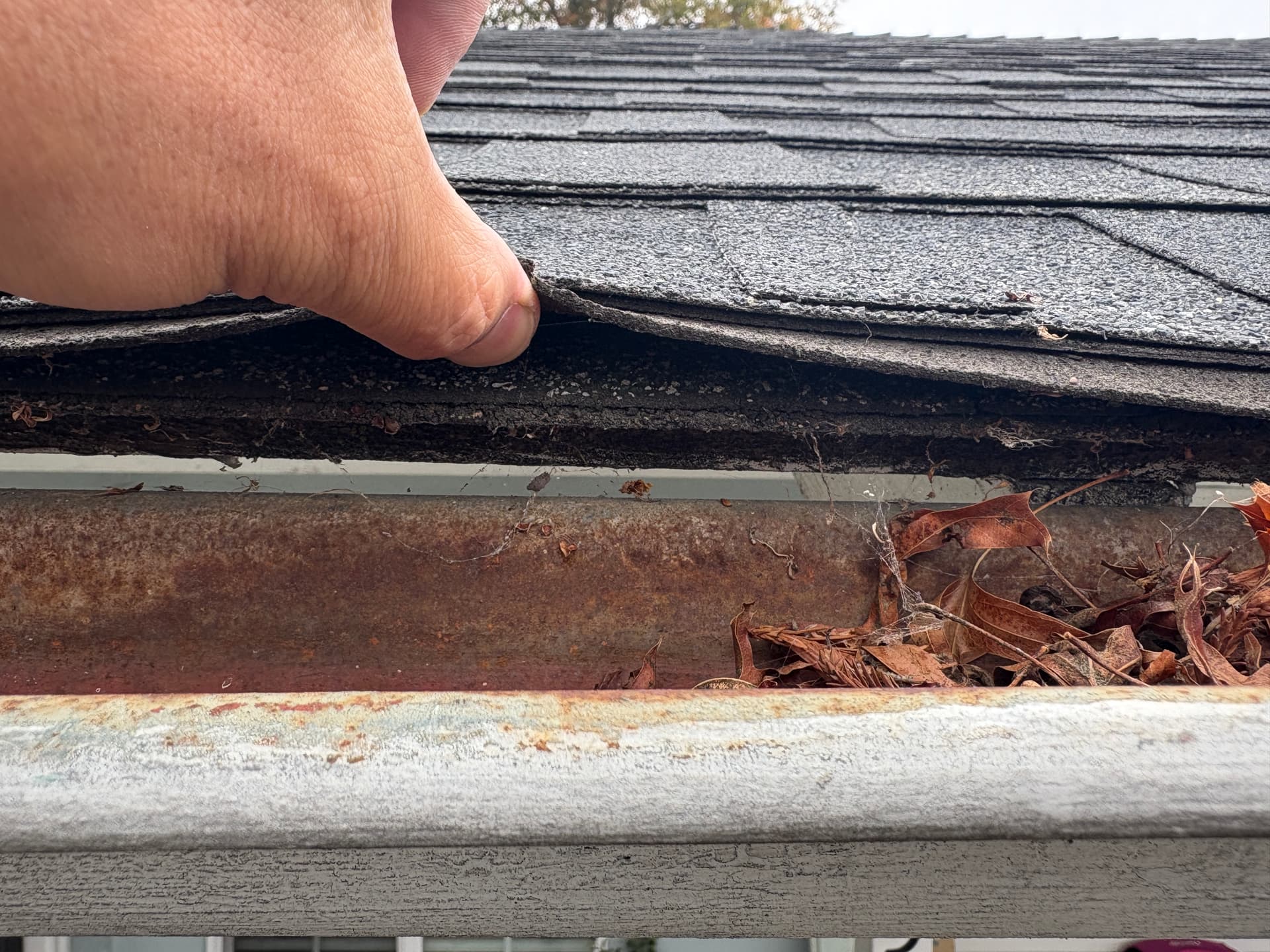

I’d appreciate your feedback on the following situation.
During a roof inspection, I observed two layers of roofing material, with a newer layer installed over an older one. I also noted that asphalt shingles were used to patch over the roof vent pipe flashings. The homeowner informed me that the seller claimed the roof was new but provided no roof inspection report to support this. The homeowner now wants me to confirm that the roof is not new, estimate how long it will last, and provide a cost estimate for replacement, as she intends to pursue legal action against the seller. I maintained my professional stance, explaining that the roof has an overlay of roofing material. I also clarified that a complete roof replacement would involve removing all old layers down to the roof deck, installing new underlayment, and then applying new roofing material. I don’t think I am in the position to offer cost estimate and life expectancy of the roof. Further more, it seems like doesn’t make sense for me to state that 2 yrs ago the roof was not a new one. Do you guys agree?

Will you share pictures with us?

The roof is new, as a roofing contractor from 1993-2008 I personally did thousands of re-roof (over lays) whatever you want to call it. But in fact the roof is new, and most everywhere in the world that installed shingles, there is nothing wrong with 2 layers being on a roof. It is also allowed per shingle manufacturers. I have torn off many roofs where there were 5-8 layers of shingles with a layer of cedar shingles over space decking.
You really did not need to escalate the matter in your report. Go out and talk to some old school roofers, then rewrite your roofing narratives.
Also a 30 year shingle will never last 30 years, a second layer of shingles will last just about as long.
The only issue with it might be insurance, but most will cover a 2 layer tear off if there was hail or wind damage.
The cost to replace it can be anywhere from $200-400 a square. A square of roof is 100 sq feet btw.

I didn’t do and of the 4 since I felt it was out of my scope of work
Thanks William for your input. You are an experienced roofer. The roof structure look week to me from inside attic

I was just curious what the completed roof looked like.
The OP appears to be intimating that the latest layer of roofing was applied 2 years ago. So in your opinion at what age is a roof no longer called “New”?
I would go to the County website and see what the permit record say. I do know in Florida two players of asphalt shingles are allowed. I wouldn’t recommend it but it is allowed.
