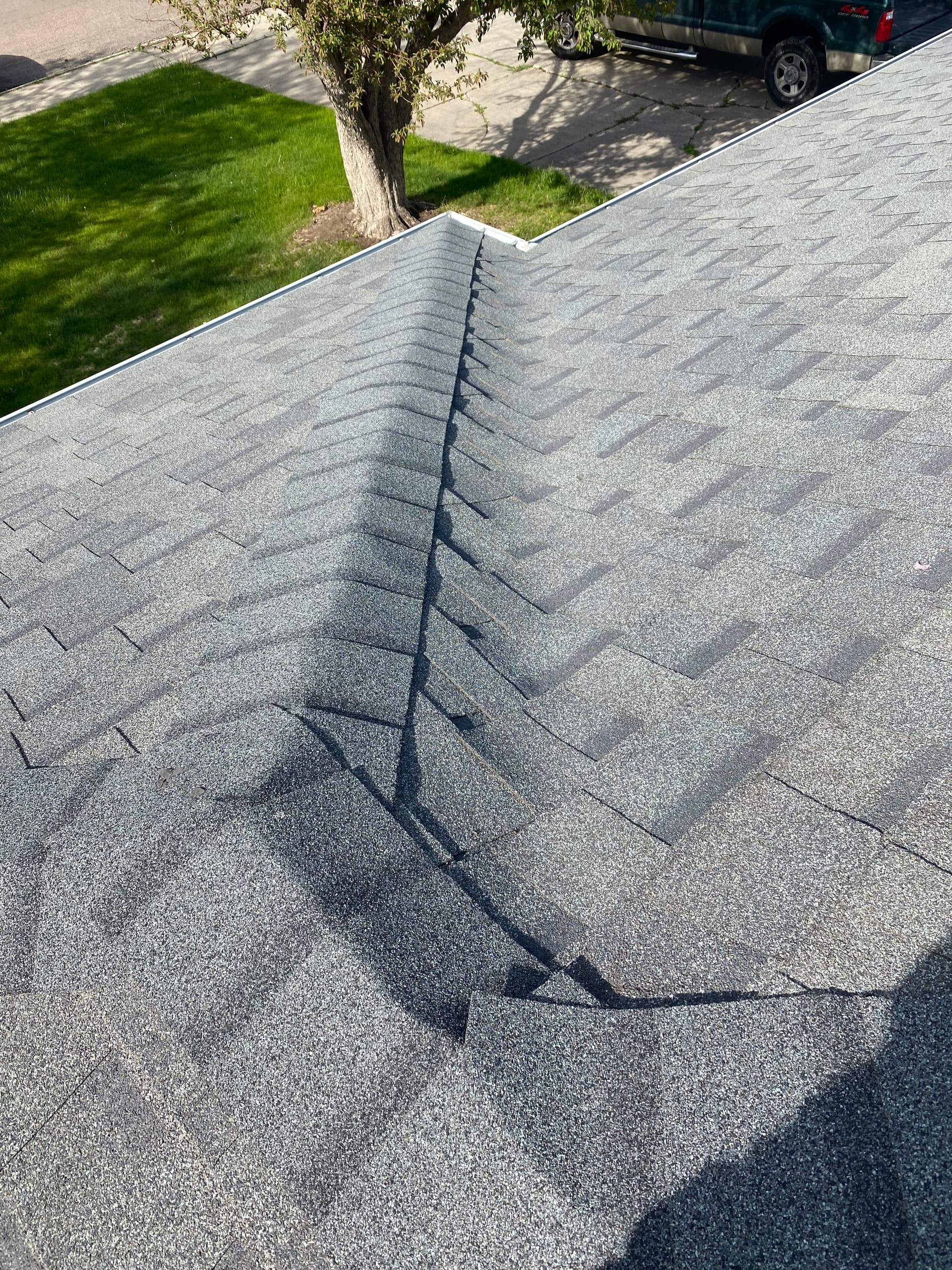

I recently inspected this roof and called out some big issues the first inspector missed. His report had delamination as the descriptor for one picture in the roofing category. The owner of that inspection company is covering his butt by saying I do not know what I am talking about. Here are a couple pictures I took when I inspected.
These pictures highlight the worst issues. I want to verify I am not the only one that sees it this way. My experience is 30 years as a roofer before I became an inspector.

It is a poor attempt at a woven valley, John. You see the defects.

It was supposed to be a closed bleeder weave I assume. The uphill side allows water to get right under the material. Hence, the leak and the reason they called me.
It is like they meant it to be a cut valley, and they didn’t cut the overlapping shingles?
Also, the lower slope should have gone under the higher slope

Can you weave a valley with architectural shingles?
When considering how to shingle a valley with architectural shingles, you must take into account their thickness and reduced flexibility . Laminated shingles are more liable to create bumps in woven valleys. Often, they are too thick to be woven at all.
They don’t look woven to me. It looks like an uncut California valley.

Yes you can. As long as the bottom course goes past the valley a minimum of 6”. I do about 12”. Then use a course running parallel to the valley as a “bleeder” then shingle the adjoining face off of that. The bleeder course seals down nicely to the bottom course. I also use ice and water shield as an underlayment.

Trying to avoid a pissing match for sure. I got involved because the owner knew I have done a lot of roofing. He wanted me to find the leak. When I saw all of the issues i asked to see the inspection report (house was purchased less than 60 days ago) to see what the inspector had noted. His roofing section had one picture and noted “delamination” as the only issue. This is a big miss for that inspector.
Not necessarily, what was his recommendation?
There was recommendation that a roofer evaluate the delamination. No mention of incorrect installation, no mention of shingles not fastened correctly, no mention of areas with no shingles at all. So, yes a miss for sure. If we dont have personal integrity and hold ourselves accountable then we are in trouble as a profession.
