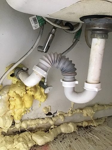

Quick question and your thoughts. Is this considered an S Trap or is it just a DIY (with unapproved flex pipe) P Trap. The Discharge pipe is still above the Weir, but its shape has me wondering. Thanks for your input as always

It is wrong and needs correction by a qualified plumber. :smile:
A slightly longer tail pipe and some correct fitting and it could be remedied. :smile:
Thank you Larry, you are always spot on, can you to elaborate a little bit of your knowledge on whys and hows?

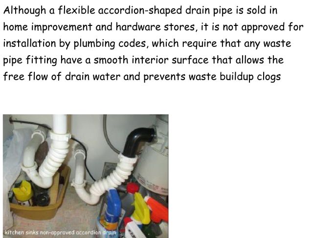

If the correct fitting was used out of the wall with a slightly longer tailpipe and correct fittings, It could work as Charles points out in this link: P-traps-installing them properly - Charles Buell Consulting LLC

Any time I see flex for a drain I write it up as an “unprofessional” installation.
Looks more like a lazy W to me.
…or lazy plumber!
