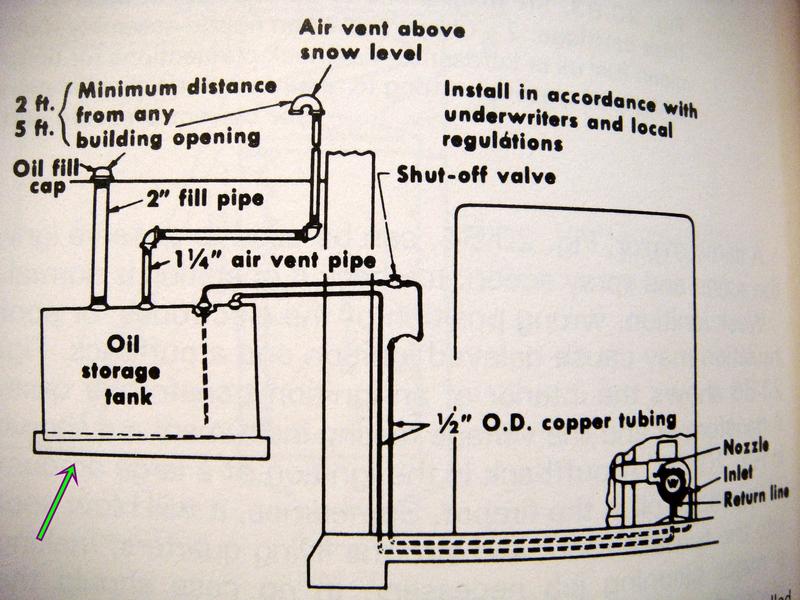

Any indoor tank should be at least 7 feet away from the furnace.
The oil storage tank should be tilted away from the outlet pipe to collect moisture and crap.
Is this an error or is it different in the US?
Here we are to tilt it towards the outlet.
If the filter is outside and temperatures are low enough fuel oil will gel.

Some ares require a spill container under the tank if inside
No more than 500 gal of storage inside ( use to be in Canada)
If the tank is above the burner a safety valve should be installed with a fuse-able link in case of fire
