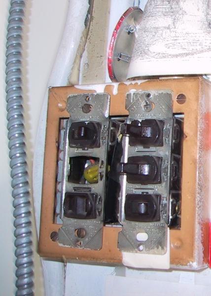

See anything here that should be considered?
I would like to hear what will be said about this installation.
Is the box fill considered here where the code seems to be silent on this product?
What are these devices called?
Despard.
If it had a proper cover plate on it, and the switches were functional, I can’t tell you that I don’t think most home inspectors would pull the cover plate to see the inside.
I see a missing screw on the sw group on the right. I see a missing sw/outlet on the group on the left. The outlets are not grounded which may be OK if the install was done during “that” time when it was normal. The box cover looks like a WireMold product based on its color. The switch/outlet plate is missing. Looks like a drywall screw was used on the sw group on the right. A paper label has been applied under the lower mounting ear of the group on the right. As far as box loading goes I would have to pull the outlets but I would guess it is packed. One thing to note is that there is no ground wire to get in the way if this an old install :slight_smile:

Box fill would be where I started after I pointed out the broken device.

That to me looks like a wire mold plate.
Wonder how long that green field is?
Referring to the original pic
That wiring method you see was not FMC, it was 12 AWG, Type AC “BX” cable, and the surface metal raceway box extension was secured to a two gang device (gem) box. If we started to discuss the box fill here, we would look for the number of fittings in the box, and begin our deductions, and count each device (strap/yoke) as 2 wires. Gets tricky and will require a detailed hands on explanation.

Post 11 cites the NEC ?, HI’s don’t do CODE, they should understand that the original comment was asking if the SMR Box extension includes the cubic inch capacity to be considered as adding addional space like we find on other boxes and raised covers.
