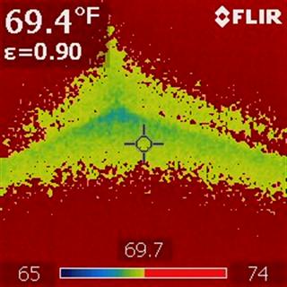

I found this anomaly in a bedroom ceiling in the same house. When I went up to the attic I found the insulation had been removed to install cable lines.
