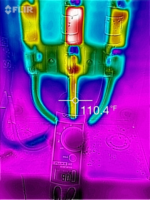

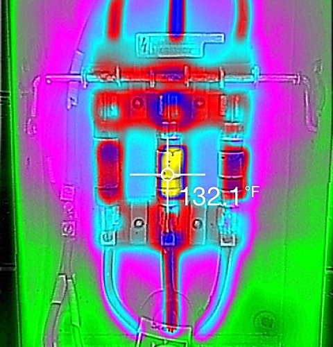

This was from my FLIR one you be the judge, plus it takes a nice video when I do my blower door test.
Stick with FLIR one!

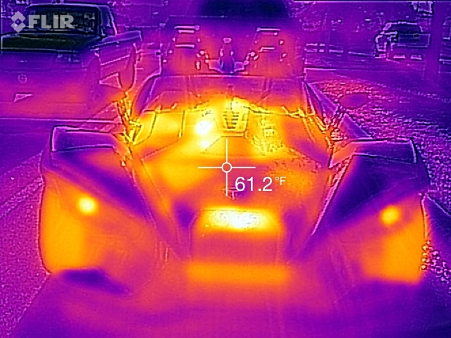

Can anyone guess what kind of hot ride this is?
The worst IR camera on the market can take images of hot spots that are easy to access. We are worried about the hard to find defects, such as a moisture area that is almost dried up and is under half inch sheetrock in a poor delta-t environment. Get some training and you will understand what I am talking about.

Obviously you don’t know what you don’t know. Those images are really bad.
I hope your pulling our leg.
One of the things that has kept many of your better IR camera prices high is the quality of the optics. (high quality germanium lenses are very very expensive). Some of the cheaper cameras we are seeing have more detectors (seems good so far… but they can now produce these cheaper than they used to). But the other cost cutting factor in the cheaper cameras is the low grade content of the lens material and the poor quality of the method they are using to produce them).
Your eyes may be 20/20 but if you try looking through some dirty sunglasses, it makes everything blurry. This is why the images in the cheap cameras still look poor, even though they have more detectors.
