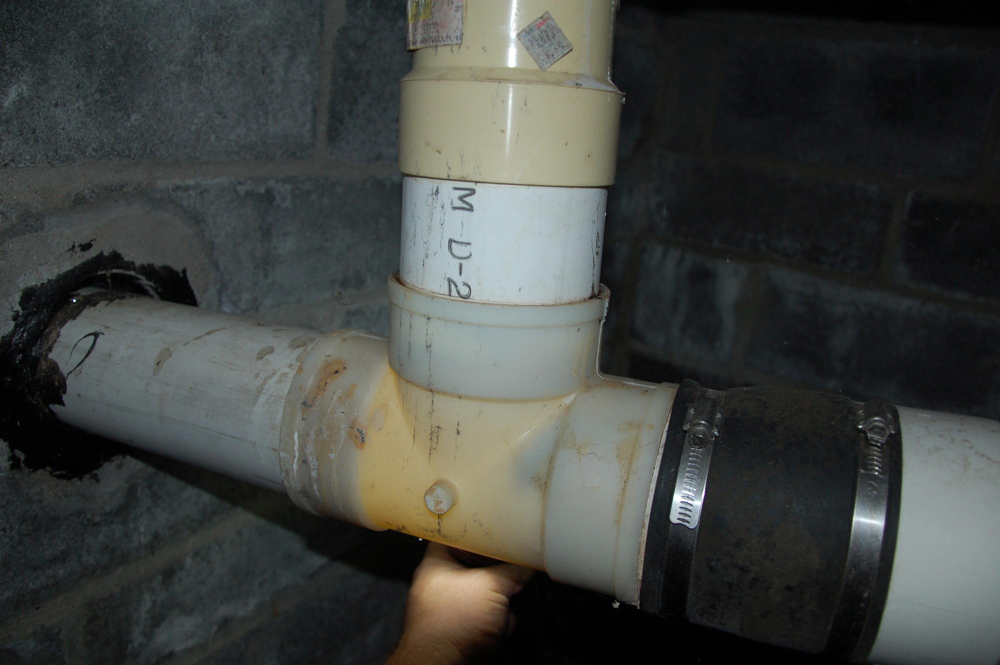

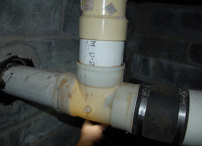

Is this fitting acceptable to join with PVC? I haven’t encountered this semi translucent material before. Not to mention lack of primer…
Thanks

I don’t believe that to be the same stuff.
The ‘translucent’ stuff in the first post looks like that cheap China plastic crap you would find in a dollar store that cheap toys are made out of.

not properly identified in the visual image do you have a mirror image of the other side showing the required marking

Thank you gentlemen. I agree that is likely the “cheap China stuff”.
And no, I do not have a photo of the other side.

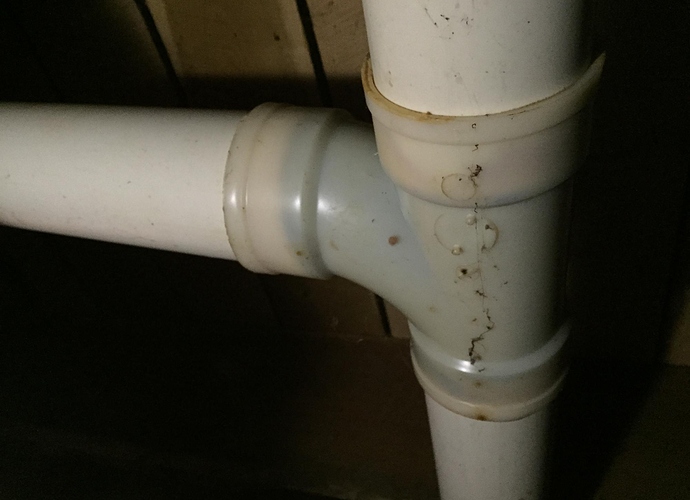

Look I found one today in NH! Do I win a prize?
