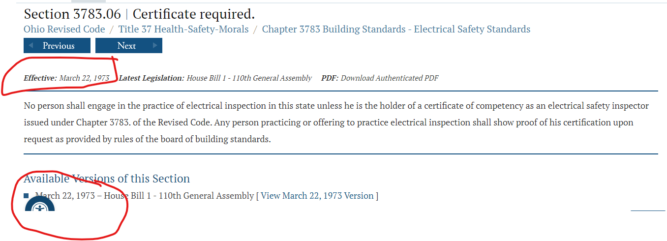

From your post above:
No person shall engage in the practice of electrical inspection in this state unless he is the holder of a certificate of competency as an electrical safety inspector
