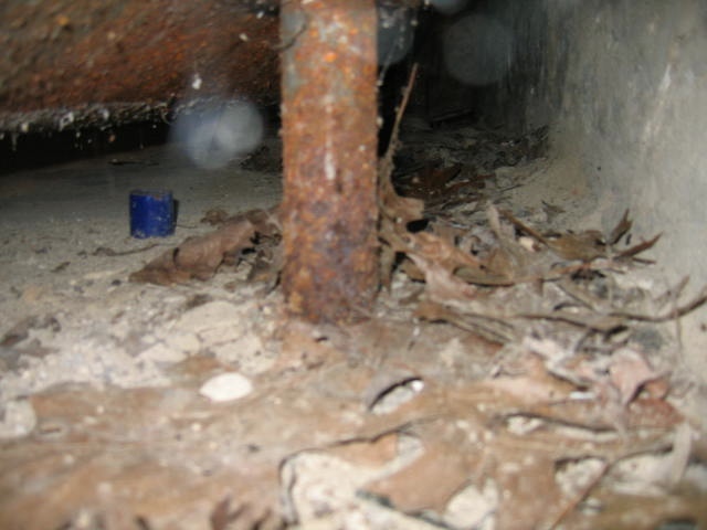

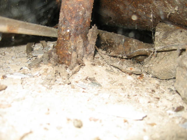

Mark I understand the point your trying to make, but any inspector worth there salt better know the size and fuel type by a casual glance. I think this also falls under client expectation. if you mention that the SOP your using excludes fuel storage tanks and you don’t inspect it, they will have a hard time proving otherwise. I personally state this in the report so they can’t come back and say they never knew.
I tend to agree with Mark on this one due the fact, that if a tank condition depicts the condition of Ben’s photos as the example, I will surely note that there is a defect with the condition of the fuel oil tanks and recommend that a Plumbing or Mechanical contractor evaluate it’s condition.
Other than those circumstances, I normally just take a photo of the oil gauge to show how much oil is in the tank.
If a defect is staring you in the face, I don’t care what the SOP says.
Report it. HI’s report the condition of the Systems and Condition of the Dwelling, therefore the oil tank is part of the systems and if something is visibly wrong, it needs to be reported.
If the HI cannot evaluate it’s condition, recommend evaluation from an expert in that field.
That is exactly my point. If you note it is there, and you don’t inspect it, you had also better note that you didn’t inspect it in your report. If you just note it, and rely on the SOP to protect you from the inspection part, I think you are likely going to be paying.
Exactly my sediments exactly.
I agree also. You see an oil tank in the basement, and looks like this.
Ah, the SOP says I don’t have to inspect it, so there is nothing wrong.
What are you going to say when the judge is coming to get you?

Inspect and report on what you can see. Can you see the inside of a fuel tank? If it is empty, do you know if it is leaking? Is it possible for a crack too small to see to allow fuel to vaporize and escape? If your inspection were to “miss” any of these things and the tank was not in working condition because of an undetectable problem, should you be accountable for that? I like the SOP just the way it is.
I see no reason to describe something you won’t inspect. The objective is reporting defects. I agree with a prior post. If I was on a jury I would make you pay for a tank you described and did not report a defect on. The odds of that are remote enough to prove that by discussing this we don’t have a lot going on this Friday night. :stuck_out_tongue:
So, I describe the heating system as a natural gas powered forced air 1984 Carrier with flexible ducts…and, according to you, I am accountable for a cracked heat exchanger. I think that many would disagree with you.
and a lot of people disagree with juries.
Because to inspect a fuel tanks properly you need to Be experienced with the ASME B Codes at the very least. Or work for a fuel company.
Because to inspect fuel tanks properly you need to Be experienced with the ASME B Codes at the very least. Or work for a fuel company. Or have some experience with Pressure Vessels and perhaps some detailed welding background. If you do not have most of these qualifications, then you should not be pretending you do, and defer this part of the inspection to EXPERTS.
