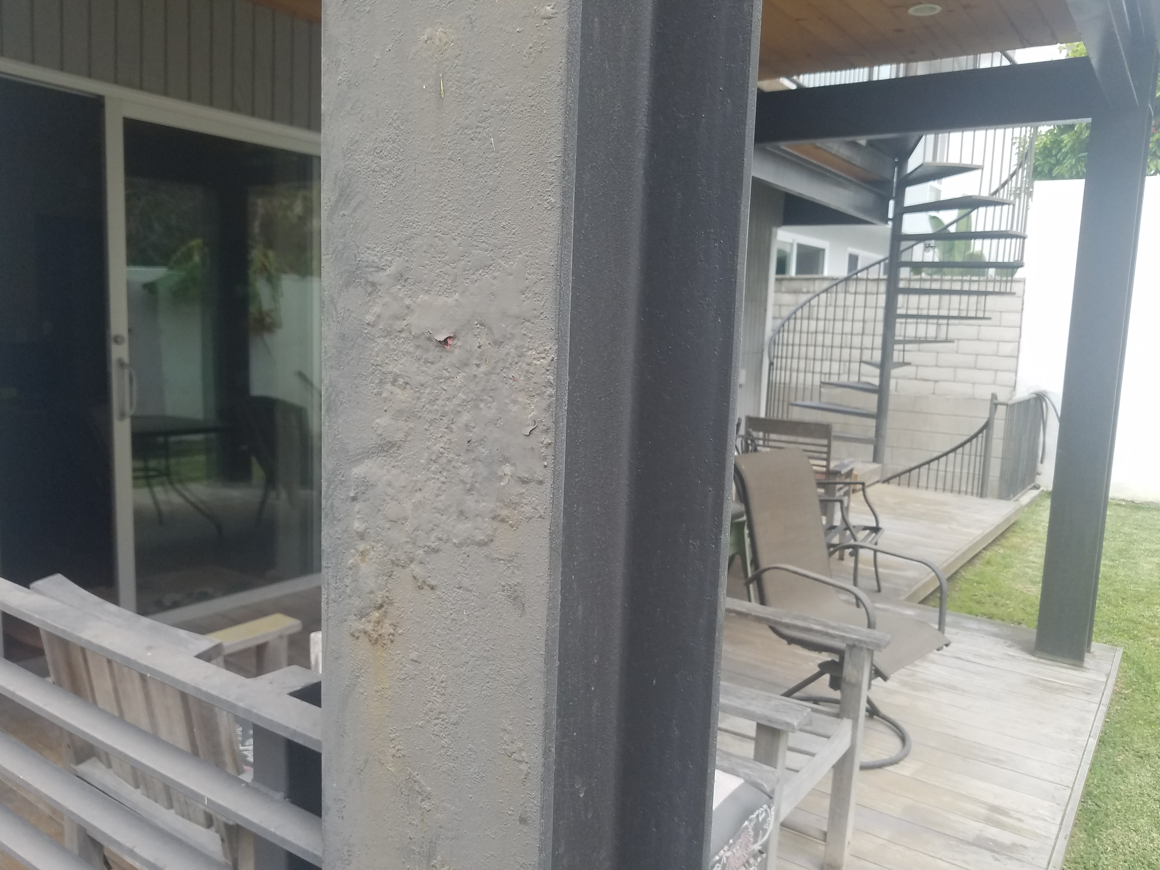

I have some metallic areas (steel I-beams and non-structural) of my house that is exposed to outdoor elements. I haven’t done any maintenance since ownership. I have some areas that are showing bubbling and rust. I attached a picture. Is that rust underneath? Can i paint over the rust or would i need to sand it off? Also for metallic is there a specific type of paint I need to use?
Yes, David, that is rust under the paint. DO NOT paint over the rust!

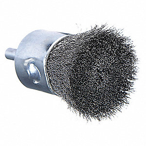

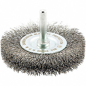

A good way to get it of is sandblasting but you probably don’t have one of those, So, a good 1/2" drill with a wire wheel on it can help get the loose rust off and down to bare metal.
Then, Prime it and paint it with a good exterior grade metal primer and paint…I would do 2 coats of primer and 2 to 3 coats of paint.
Thank you for the reply. Just purchased the wire wheel set you mentioned. I also have a orbital sander too I could use.
Question- For areas of the exterior metal that do not show any rust or bubbling- Would i still need to apply coat of primer or could i just add a top coat on top of the existing coat?
