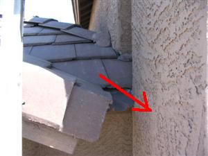

no, very seldom do you see kick out flashings. A big concern of mine is when the roof meets at a column usually for an upper portion of the roof. The problem is the brick sticks out a little further than the veritical wall. It looks like a place for disaster. See picture.
Kick-Out?..-X
Woops, here is the picture. See were roof meets brick. This job I was able to actually look between the vertical wall and brick and see exposed 2x4 studs.
There was flashing though.
Pathetic, but very typical for new construction…:shock:
The bottom of that vertical wood trim on the high side of the bricks will certainly rot in a few years. Dirt and debris will pile up against it and keep it damp after any perception.

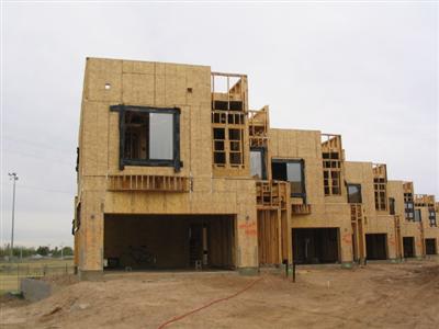

Here is the moisture wrap you get in AZ. around the windows, and they went out of their way with it on this Condo complex…
