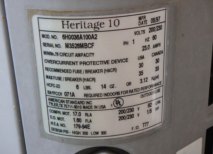

This is a split system unit. It is a 1997 unit. This unit is currently 19 years old and may be approaching the end of its useful service life. Recommend having the unit serviced by a licensed HVAC tech to prolong its service life. Budget for an eventual age related replacement.
Recommend having the coils cleaned and all vegetation and debris removed from around the exterior of the unit for proper airflow.
