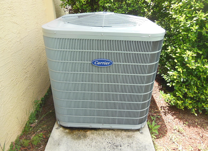

This is a photo of an electric heat pump. It was manufactured in 2009. It is manufactured by Carrier. The supply line is well insulated.
