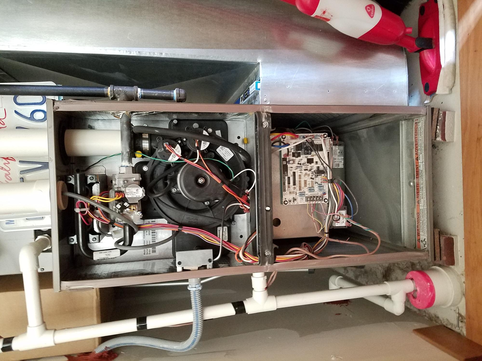

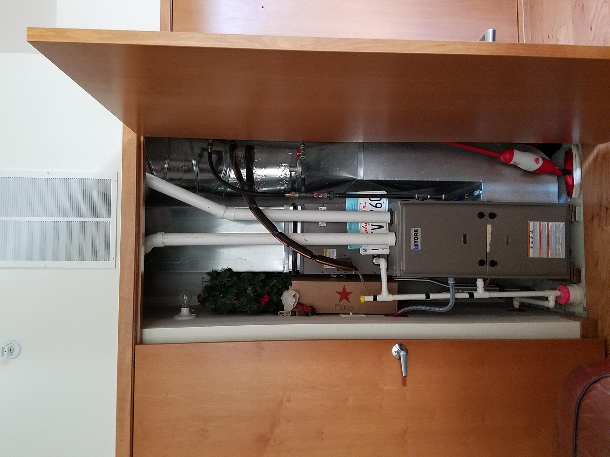

This is a York model TG9S040A08MP11B, 40,0000BTU input and 38,000BTU output, gas-fired, direct vent forced air up-flow lowboy furnace. It is 95% “steady state efficient”, relatively new, well maintained and in good condition. It is configured as an up-flow unit with the supply plenum above the unit and the return plenum low to the side of the unit. The supply diffusers are ceiling mounted and has a high return grille. This is an ideal configuration for summer cooling. A possible upgrade to the design for winter heating, would be installation of a low return with a damper to close during summer cooling, to draw the high warm air supply down through the space into the low return.
