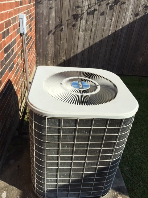

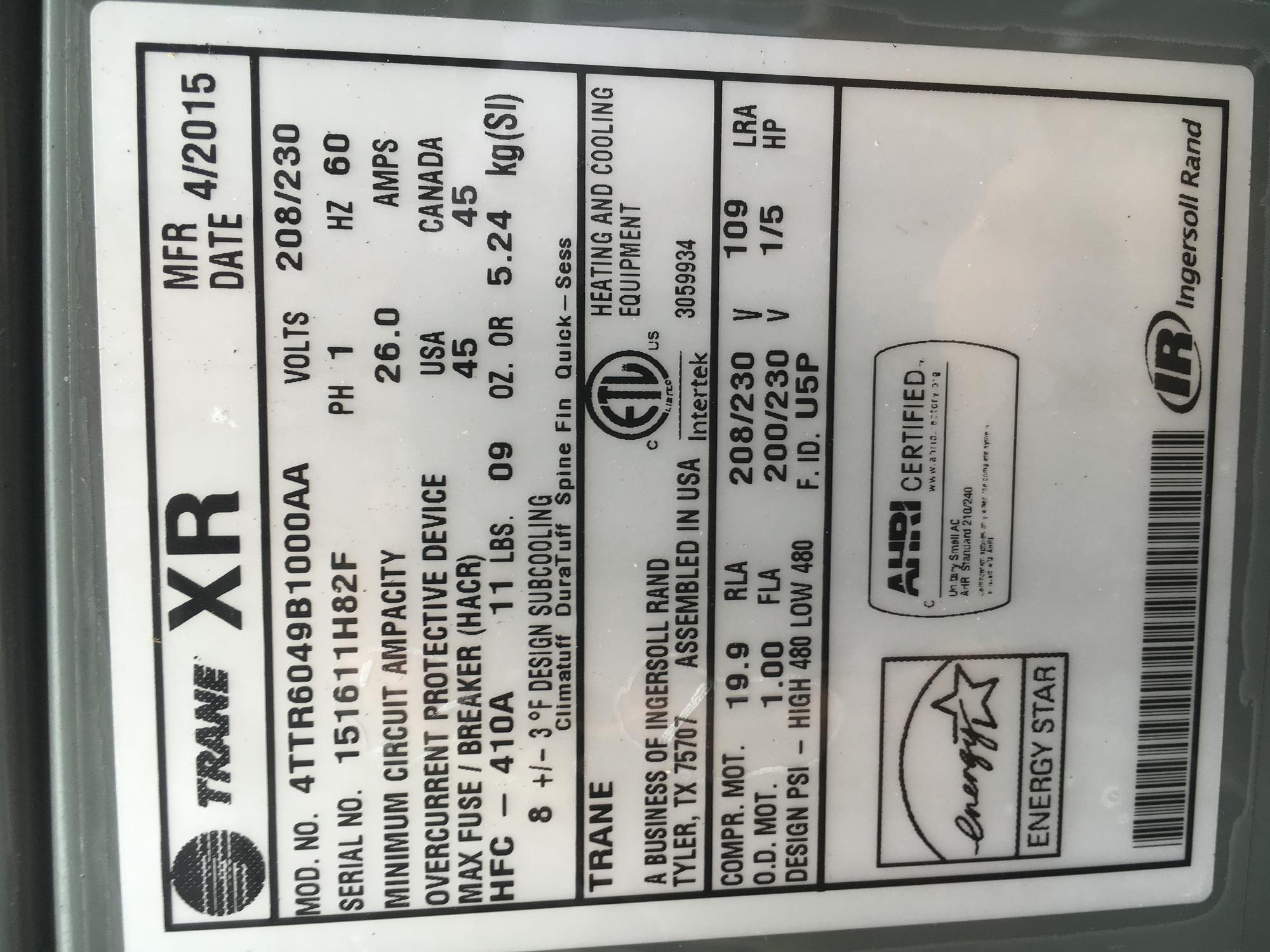

This is an image of the A/C Unit located at the side of my home. The second image is a shot of the data plate. To determine the size of this condensing unit, you refer to the model # on the data plate.
The model # is SCU10G36A – 1. The size of this unit is a product of the # of BTU’s divided by 12; in this
case: 36/12 = 3 Ton. The second piece of information from the data plate is the serial # 1604L02661.
If you go to: www.buildingcentre.org you can check the manufacturer and find the date that that piece of equipment was manufactured. In this case, it’s an Armstrong product, which when completing the search on the website, shows the types of serial # indicating that this unit was manufactured in 2004.

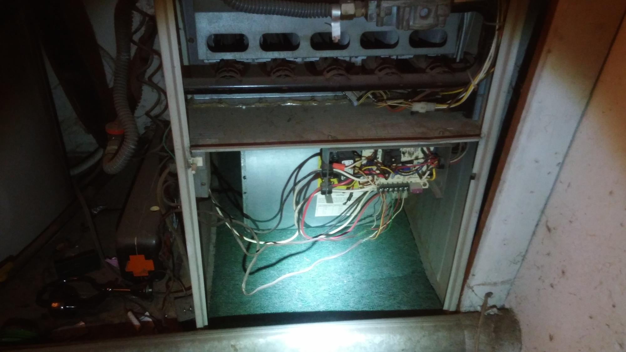

I inspected the furnace in a friends home, during my inspection I found that this unit was built in June 1988. this is a up flow natural draft furnace. in the picture you will notice that this unit has a washable filter that seems it has not been washed in a while as well as it is missing the top retainer spring, they have also used the area directly to the left of the furnace as storage.

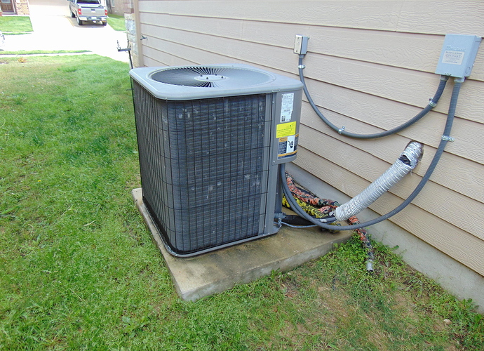

I have pictured here an outside unit (Condenser). Its age is not yet found. The aluminum fins are oxidized and eroded off in some areas. The fan is running and the unit is working properly. The paint is faded and rust is popping up on the exterior case. A disconnect box can be observed in the picture. This is a switch that cuts the power off to the unit in case servicing is necessary. The outside unit also houses the Compressor for the unit. The compressor compresses refrigerant gas back into a liquid which is sent to the capillary tube just before the Evaporator coil to become a gas again in the refrigeration cycle.
