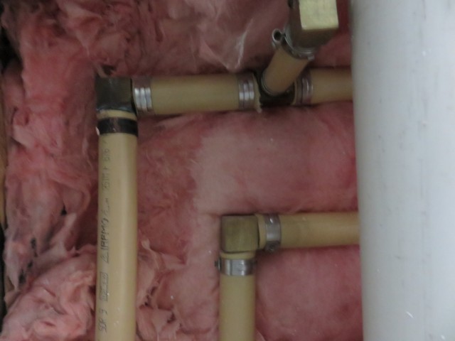

Polybutylene is a plastic manufactured between 1978 and mid-1995 for use as piping in home plumbing systems. It was cheap and offered plenty of advantages over the other materials. Polybutylene pipes were rupturing and causing a lot property damage. In the homes that still contain this material, homeowners must pay to have the pipes replaced or risk not getting home owner’s insurance. In Florida, most Insurance carriers will not insure a house with Polybutylene or PEX piping. Polybutylene Pipes Should Be Replaced. Just did a Home Inspection on a 1998 Town House that has Polybutylene, needless to say the buyer backed out

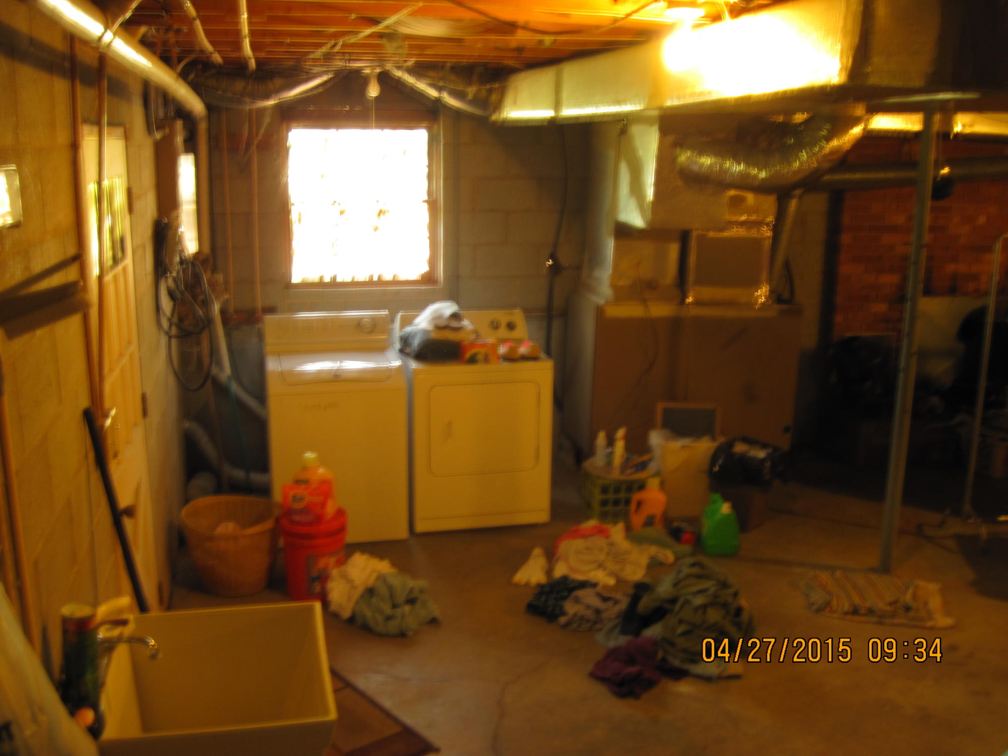

This is a picture of a gas furnace and two gas water heaters with plenum duct work. No, the dryer next to it is not hooked up.

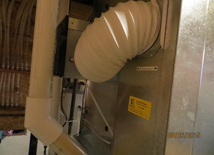

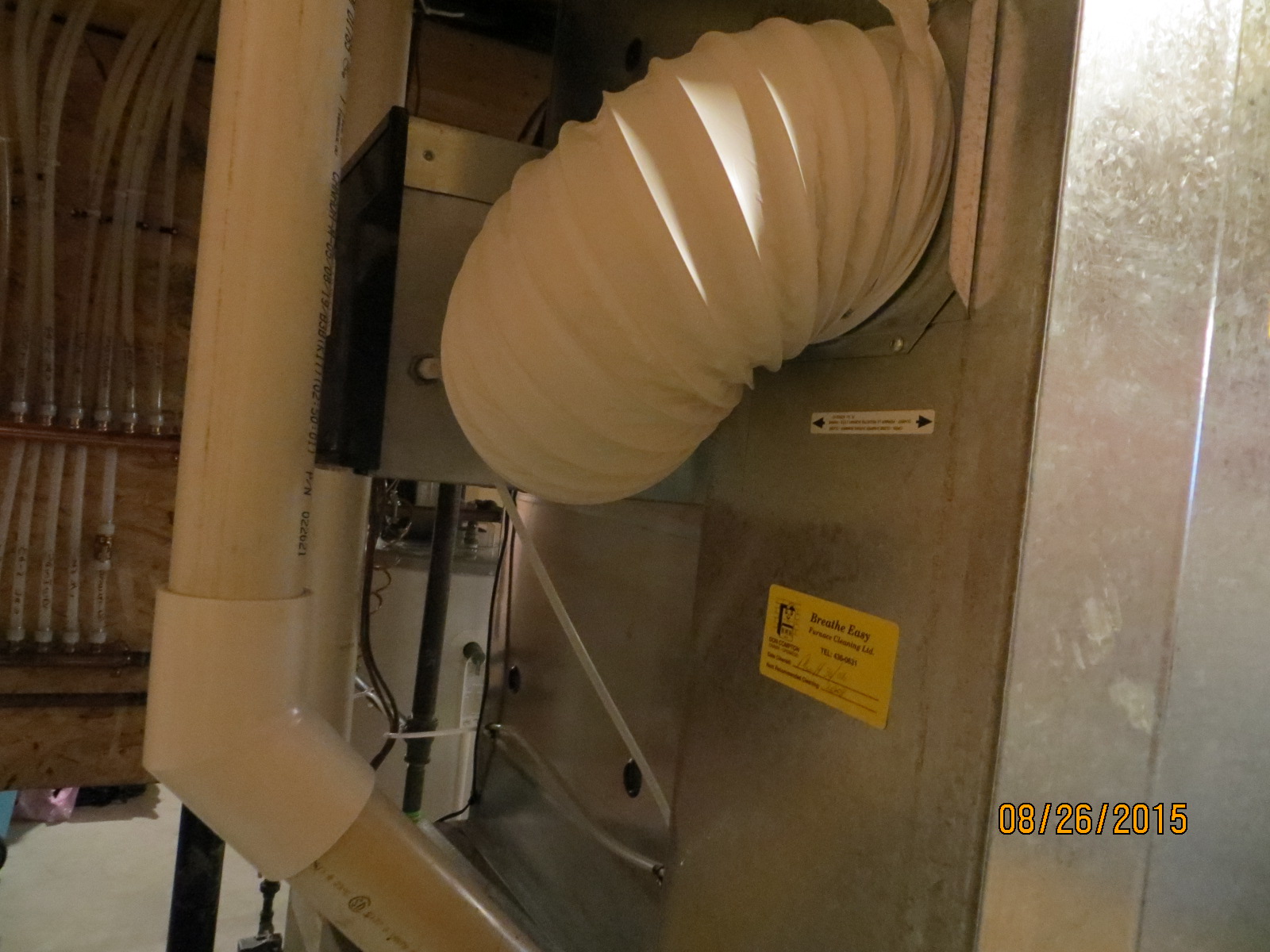

Here are 2 photos of the Furnace Humidifier and Hot Water Heater
I checked and replaced the Furnace disposable filter only yesterday ( last change May 2014 !!) and it was really dirty and should have been replaced earlier.

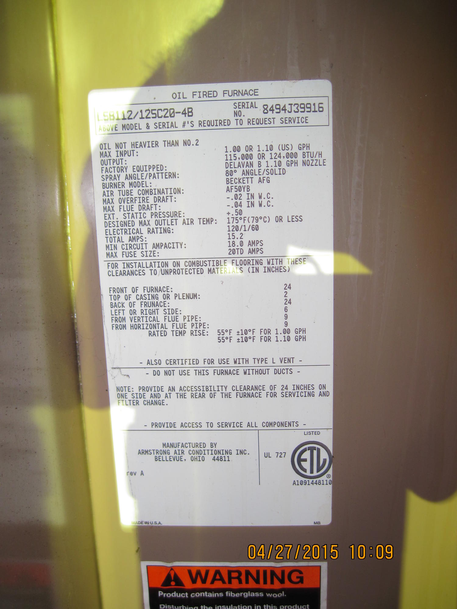

I uploaded two pictures for the Share an Image Requirement. They go hand in hand with each other. Picture one is of an oil fired furnace located in the basement of a residence. As you can see in the picture, the furnace is almost against the concrete wall. The second picture is manufacture sticker on the furnace which clearly states at the bottom to provide access to service all components. The components on the back can not be reached without moving furnace.

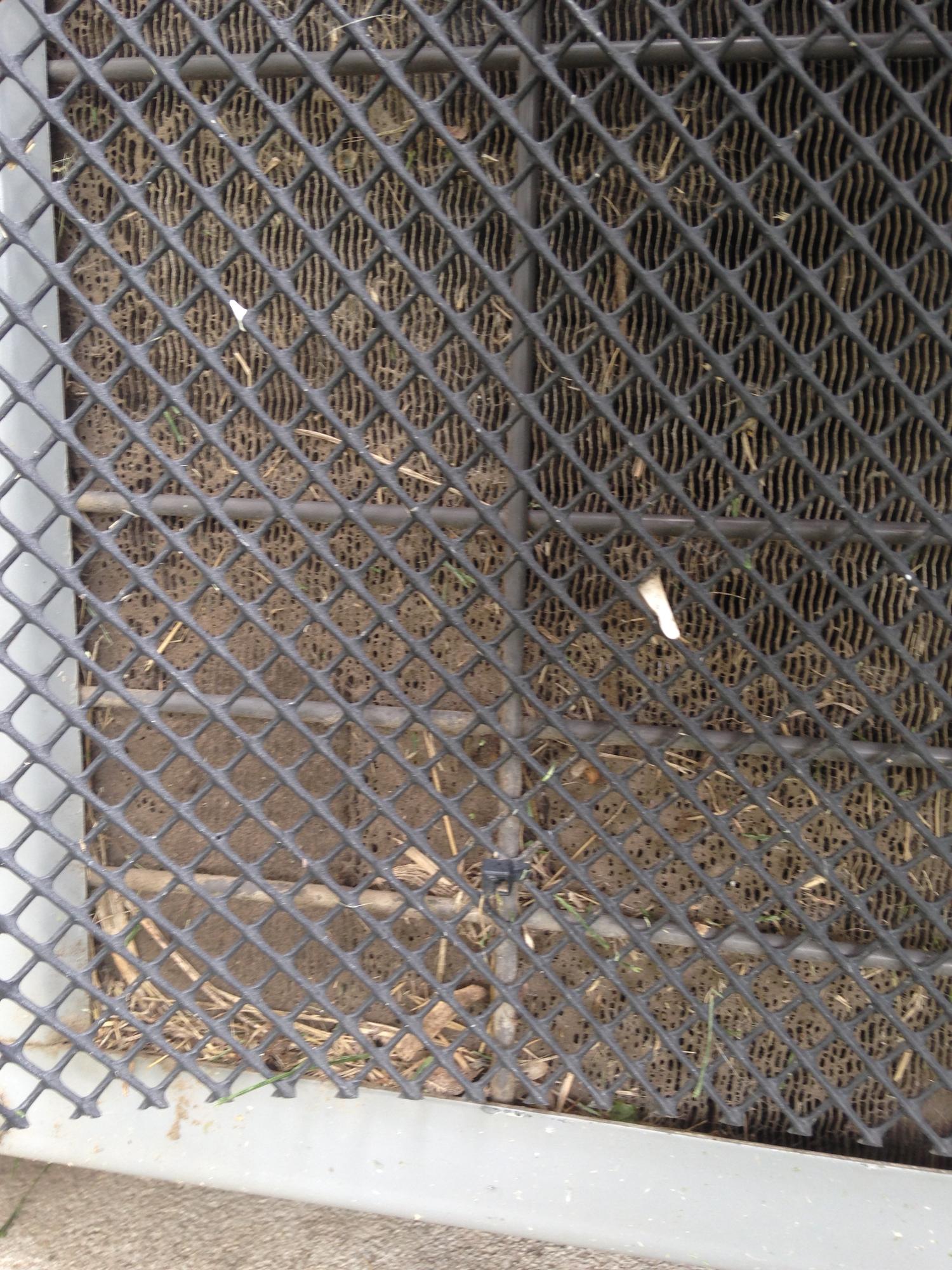

As a requirement for this training course, I have chosen to upload my image showing dirty cooling fins on an exterior AC unit. Living here in SD, it’s windy 8 days per week, and nearly every unit is caked full of dirt, cotton, and other debris. I believe it’s a forgotten part of standard home maintenance, and I always make sure to remind my client that hosing these fins off will make their unit run more efficiently.
