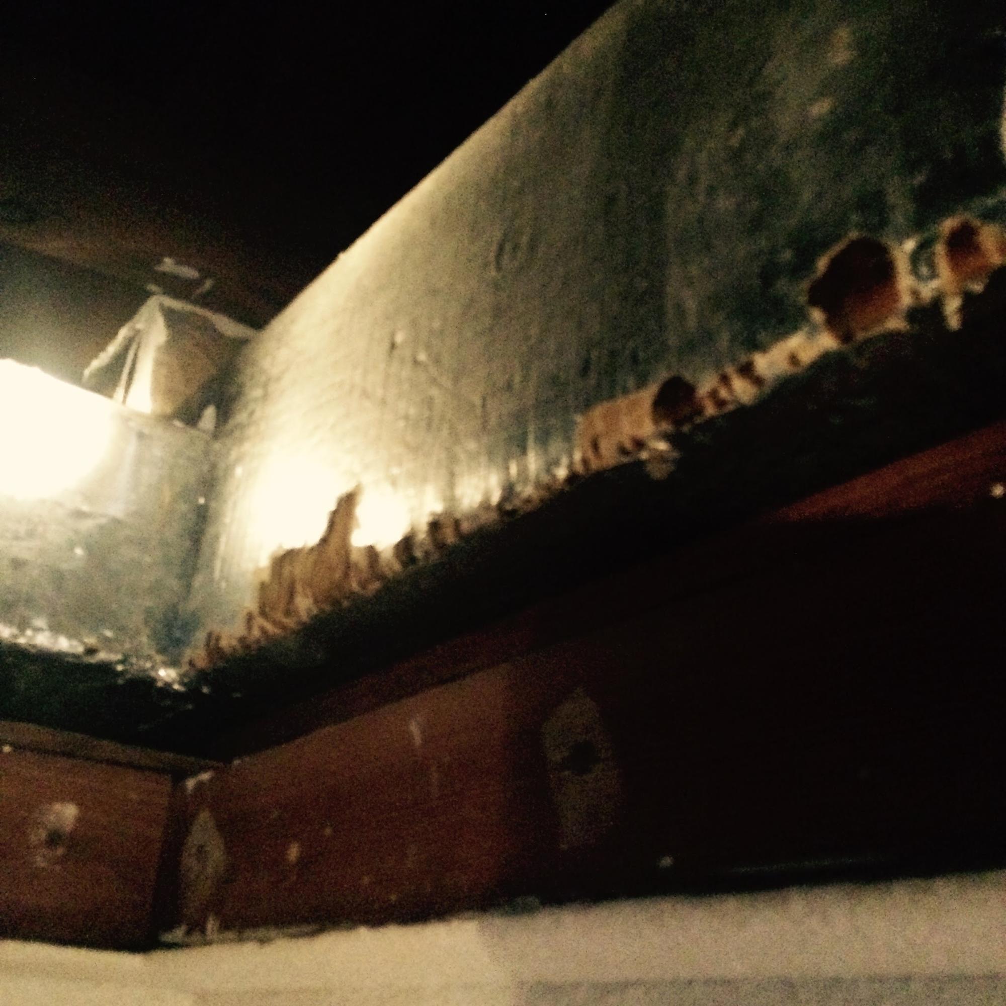

This is a picture of some very old AC duct. Where some critters and age has worn the foil off. To try to fix the problem the owner painted the duct with some old house paint. It helped some but can still feel cold air in attic space. I think to save money that all the duct should be replaced

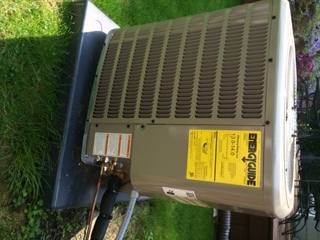

This is a brand new Goodman 2 ton condenser 13 SEER. It is connected to code, the disconnect is located right behind the condenser. The condenser is connect to a 2 ton evaporator coil inside a natural gas burning forced air heating unit in the basement. Insulation on the line is present and in good condition. No cracks or dent/crimps found on any lines.

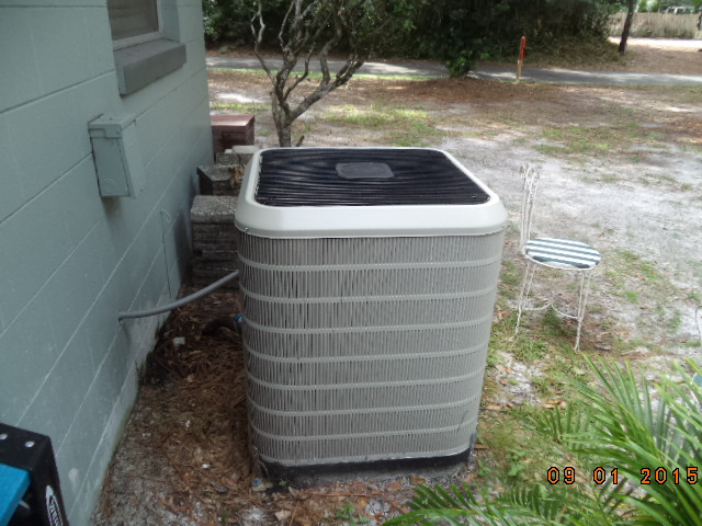

Inspecting HVAC Systems

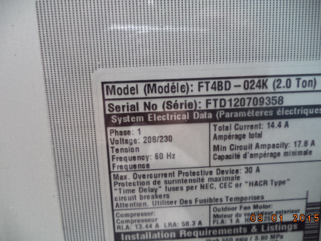

I inspected a split AC system which is a gas-compression system.
The system was turned on an appeared to be cooling efficiently.
After inspection of the technical information found on the condenser it is a 2 ton unit.
There is a breaker box for safety and service turn off located in sight of the condenser.
The unit was producing condensate water at the exterior drain.
A visual inspection was done of the interior blower/evaporator. The system was sounds smooth but there were some signs of excess condensation on the pipes and body of the unit. This needs to be checked out by a service technician.
See inspection pics attached.

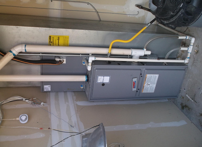

Hello students, I am posting a picture of a medium efficiency gas furnace. It is an up flow. This picture lighting is poor but you can see the burners, ventilation, and the draft inducer. This furnace is in working order and shows no obvious signs of disrepair.
