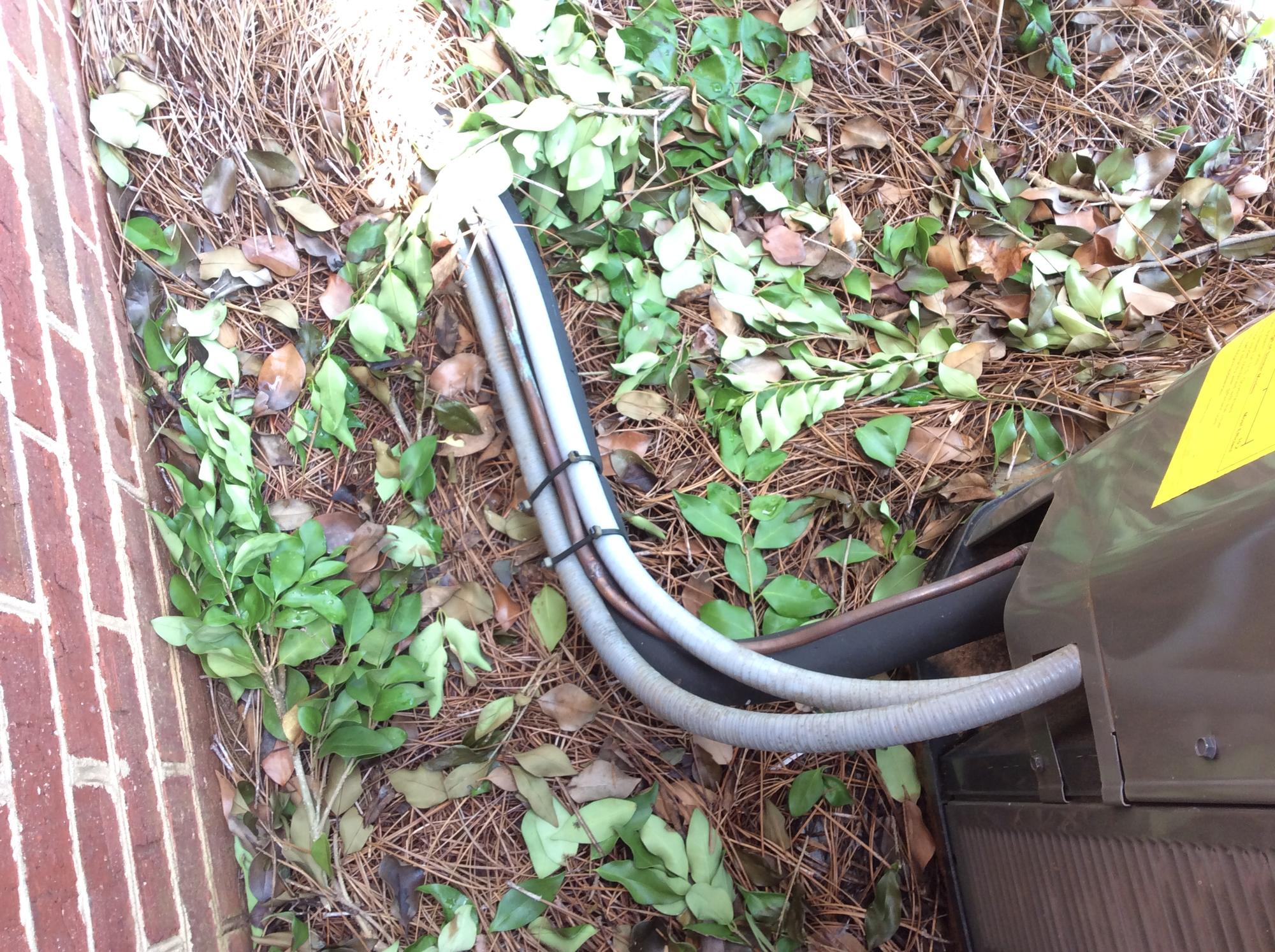

I inspected the heating and cooling system of a residential home. The thermostat is located in the dining room on the south wall next to the closet containing the central heating and air unit. I operated the unit using normal operating controls. There is also a combination unit upstairs. The thermostat is on the south wall (closest to the street) next to the stairs. The upstairs unit is in the attic.
The attached picture shows one of the two evaporator/condensers. The unit on the left has vegetation growing around it which includes vines. I recommend keeping the vegetation away from the units to ensure efficient operating conditions.

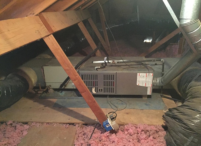

As a requirement of this course I am inspecting the HVAC system. The unit is a carrier Mid-Efficiency gas forced air. The unit is located in the attic and the condensing unit is located out side. The thermostat is in the hallway downstairs. The unit operated fine using normal operating controls.The duct work all comes off of one plenum . The duct work looks to be connected as should be. The Return duct has som damage and needs to be checked.
I would recommend to the client that the duct work be checked by a qualified service technician.
