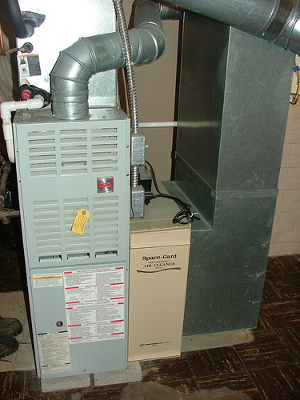

I inspected an up flow natural gas furnace. This furnace was made in 1975 but appears to be in working order. It has a constant pilot ignition. The burners lit and the blower started a few seconds after when thermostat was turned up. Sticker on the side indicate the last cleaning was done in 2002. Recommend cleaning the furnace and changing the filter. Given the age of the furnace, it’s recommended to speak with a licensed mechanical contractor about servicing or replacing with high efficiency furnace.

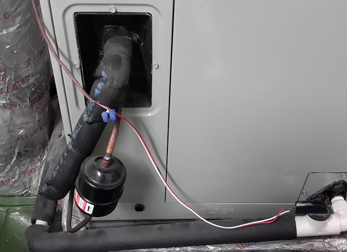

This picture represents the evaporator coils of a gas exchanged air-conditioning system. The aluminum fins look good without any damage. There does appear to be some dirt on the surface that may benefit from being cleaned by a service technician.

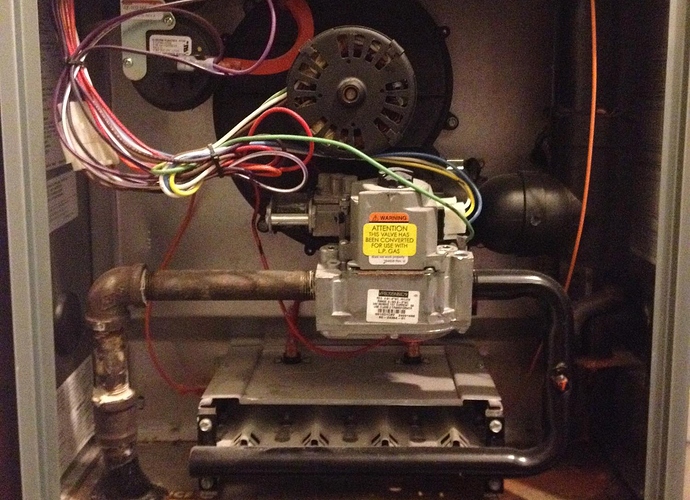

This is looking inside the panel of a propane-fired, forced warm-air heating system. This particular system is downflow, which means the return air comes in through the top of the furnace and flows to the bottom where it is supplied to the house through ducts and registers in the floor.
In this picture we can see the shutoff valve (red knob), the gas/propane valve attached to the manifold, the manifold, the draft inducer fan, the burners and some wiring. And possibly some other components I was unable to identify.

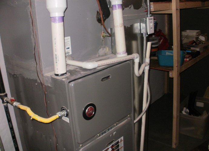

The only defect I can see on this unit is some rust in the bottom right of the chamber here. This is a high-efficiency unit which produces condensate and it appears some of that condensate is not being drained properly.
I would recommend having the unit looked at by a professional HVAC technician to see how we can address that rusting problem. I also would recommend checking the air filter(s) every month and maintenance by an HVAC technician annually.

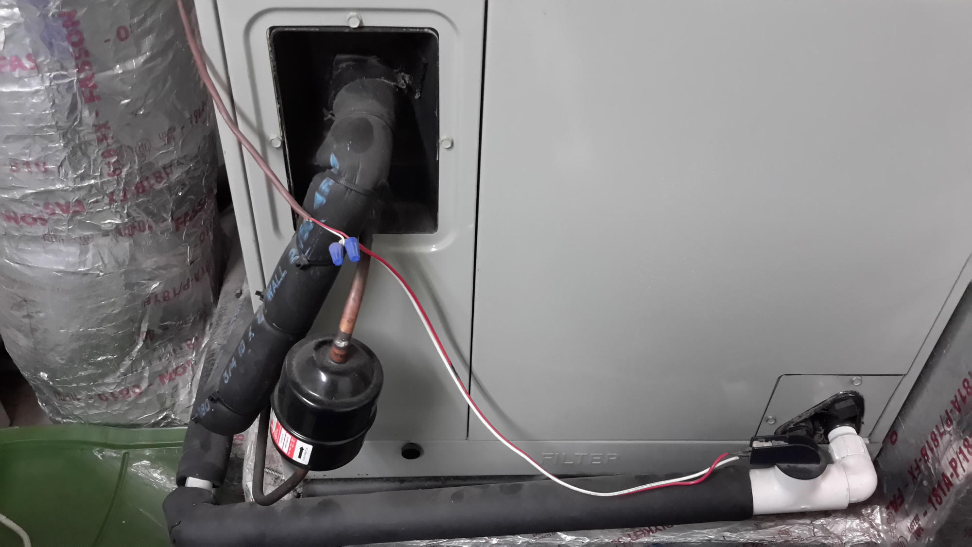

[ATTACH] a/c[/ATTACH]the evaporator. Everything here looks good, all lines are insulated showing no signs of dents or damage. the return filter is in place, this system also has an automatic shut off in the drain pan line. If the line becomes plugged and backs up a float switch is activated, shutting the system down. Queston. Does the freon filter ever need to be changed?
