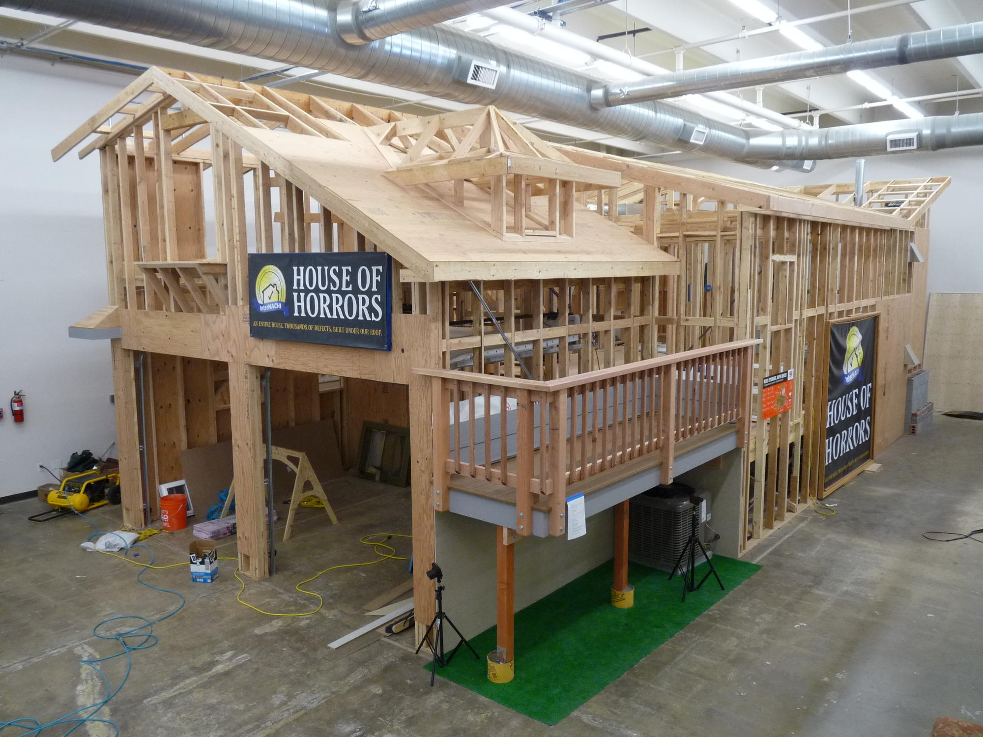

Looking for suggestions for the House of Horrors. Nothing too obvious. Defects that are not code violations are especially good.
BTW, the deck in that image has 35 defects.
Is that including the Condenser unit?:wink:
Curious, if not a code violation, and excluding poor workmanship or substandard materials, why would it be a defect?
Don’t put ice and water shield or another approved eave protection below the shingles at the eaves (obviously not required everywhere)…
Many defects aren’t the result of a code violation, poor workmanship, or substandard material.
Stuff in the world just breaks, blows away, gets damaged, gets wet (when it should be kept dry), leaks, is misused, is overused, burns, becomes outdated, is unsafe, gets moldy, or simply wears out from age.
For example: Most roofs in the U.S. aren’t replaced because of code violations, poor workmanship, or substandard material. They’re replaced because they got old.
True, but isn’t this project brand new. I guess damage can be simulated though.
Nope, that’s not part of the deck. It is wrong though.
That deck needs a bay sliding glass door/cantilever.
Slap a 90 Day Widget Warranty sticker on it. :twisted:

Hows about some real life defects as observed in the field,
  1. Liquid refrigerant line smaller than the MFG stub out on the condensing unit.
  2. Supply air plenum constructed of wood.
  3. Supply air trunk line to many drops for the size of the trunk line.
  4. Improper size of the supply duct for the size of the room supplied.
  5. Supply air duct with no insulation in a non-conditioned space
  6. Flex supply and return air duct improperly supported
  7. Ridge supply duct improperly installed from the supply register to the take off at the supply air plenum. Metal duct is required to be installed starting at the plenum and traveling to the register. The crimp on the duct always flows toward the register to prevent air flow restriction
  8. Improperly sized return air air duct and or register. Improperly sized duct will have excessive noise
  9. Low voltage wire to the exterior condensing unit traveling in the same conduit as the 240 volt circuit
  10. Exterior condenser fan motor rotating backwards. I will stop at 10 defects
