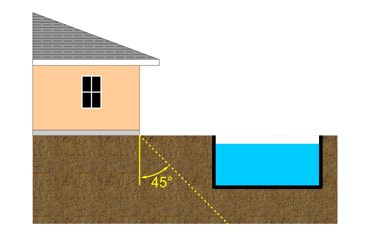

Tim,
In general any excavation should not encroach on the 45° dotted line I drew in the picture with out some type of shoring. So if the pool was excavated 8’ deep the excavation should have started 8’ from the foundation. Once you past that 45° line you take a chance of having foundation settlement issues.
Some pics would help but sounds like you are going to need the services of both a geo-technical and structural engineer.
