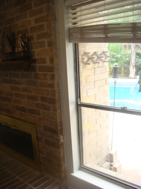

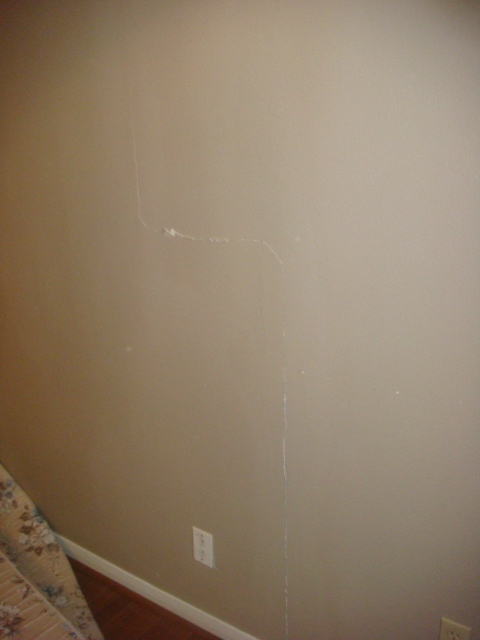

Noticed the driveway was really offset at all the sections. Vertical and horizontal crack at master bed, vertical crack above master bed door, up bed door sticks at frame, fireplace movement due to the caulking separating on both sides, and the chimney outside has a fairly good sized separation that has been caulked. One other bed wall has a vertical crack that has been patched before and now has reappeared.
The sideways pictures (first pics in both secquences) make me dizzy and I don’t see what you must see. The other interior pictures where I can see the drywall cracks, they look typical and minimal to me.

I’m used to seeing diagonal cracks off the corners of wall openings when there’s been foundation movement. When I see vertical and horizontal cracking it’s often cracks following joints in drywall.

If its a foundation issue then you need to be showing us some pictures of the foundation itself including around the footer…otherwise its nothing more than unfounded speculation based upon some sideway pictures which make my neck hurt.

Yep. Soil movement may be from heaving due to expansive soil or frost heave, in which case it may continue; or it may be consolidation due to poor compaction at the time of original construction, in which case it’s often stable.
The step crack is not normal. However still to many questions. What condition was the foundation in? Are there any rooms upstairs where the step crack is? If not did you go look in the attic to see what might be up there?
