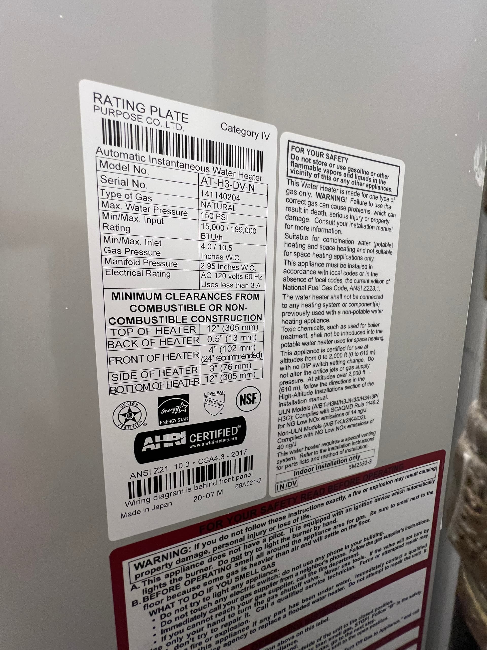

This is what the Building Center website states (that the year is encoded in the serial number - see link below).
https://www.building-center.org/takagi-water-heater-age/#google_vignette
However, I just ran into one that has a serial number of “141140204” (2014) and an ANSI date of 2017 all on the same sticker.
